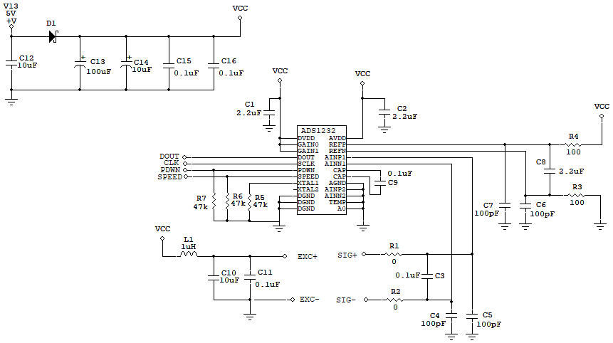

I have a ads1232 on a PCB connected to a microcontroller. Load of 10kg 2mV/V.

My schematic is based on ADS1232REF with the same filter input and reference voltages, capacitors, resitors and so on. Just with the different that DVDD is 5V, same as AVDD., on pin PWDN and SPEED a 47K Pull Down resitor and connected to the microcontroller, TMEP and A0 to ground, GAIN0 and GAIN1 to 5V.

  • Hi Bob,
    Thanks for your answer.
    This is my schematic and soon i hoope to get the data file with the readings, beacuse i just view this data in a LCD, then i'm going to send this readings to the laptop and capture in a file.

    As a baseline measurement, you could create a voltage divider using two 10k resistors from AVDD to gnd.  At the midway point of the two resistors you could short the AINP and AINN inputs together. This should give a consistent 0 V input and you should not see the output result drifting.  The result should stay within the value of the noise tables shown in the datasheet.
    Is there a particular reason why D1 is in your circuit?  Can you give me a part number for this diode?  I would suggest removing the diode and replacing with a short or 0 ohm resistor to see if that makes any difference.

    I take in count your advice about warming up and seattling time of the device, and I decided do a review to the PCB and i found a really small piece of flux between inputs pins of the device, and even continuity and isolated test was good, but i think that was the problem, because i clean it with alcohol isopropilic and now is working good. The values are really stables.
    Really thanks for your help
