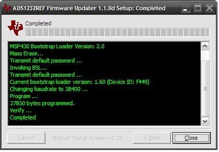

  • Bob,
    Thank for your response. This is what we are doing:
    When we load the TI firmware using the firmware updater in USB mode as instructed, it works fine as shown below. As can be seen in the window, it seems to transmit default password.

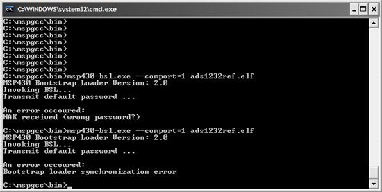

    However, when we use msp430-bsl.exe to upload the firmware we built, using the switch in USB position, it seems to fail due to password error as shown below:
    When we did the same thing with switch in JTAG prog mode we are getting "Bootstrap loader synchronization error" as shown below:
     Could you please let me know the right procedure to load our firmware? Can we use our file with the firmware updater (ADS1232REF_Firmware_Installer) provided by TI?

  • Atley,
    Try adding the switch '-epvr' to your command line.  This will erase the current memory, use the default password, verify the upload, and reset the device.
    Bob B
  • Bob,
    That worked perfectly! Thank you very much.
