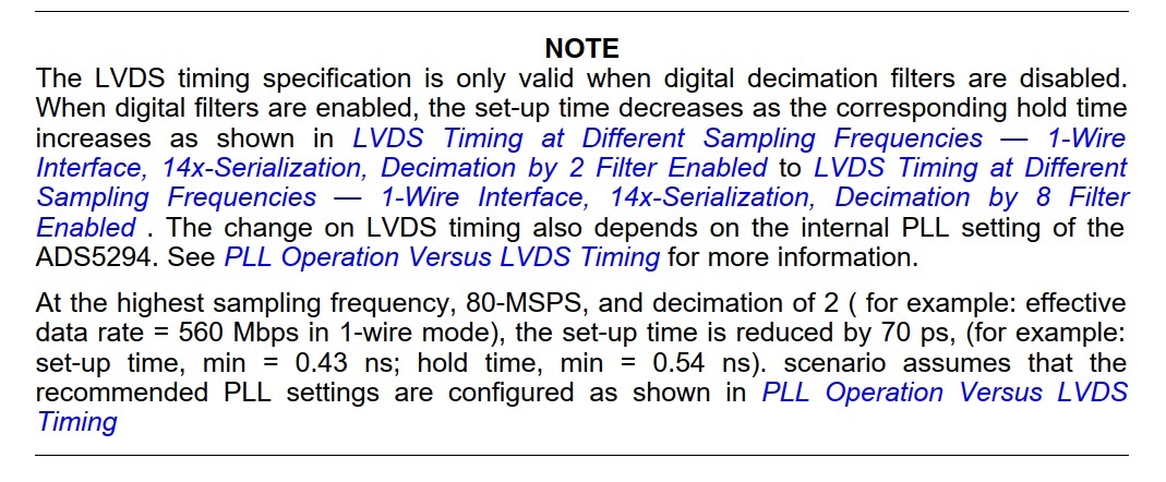

Part Number: ADS5294
Dear Team,
A customer wants to use ADS5294 as a 2-wire setup, with the decimation by 2 filter enabled @ 62.5MHz. The datasheet does not seem to provide much information on such a setup.
To be certain, I will appreciate if we can provide setup and hold times for a situation like this to the customer.
Additionally, for the bitclock frequency calculation, they asked if the following calculation should be valid:
(62.5MSPS*14bit)/2 wires/2 decimation/2 DDR = 109.375MHz.
