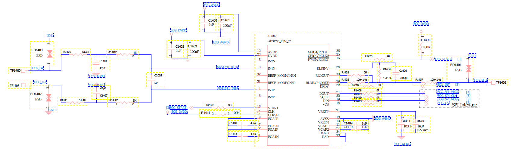

Hi Ti,
I am using ads1291, I have some questions. my register setting is:
//CONFIG1
0x00, /* 125 SPS */
//CONFIG2
0xE0,
//LOFF
0xF0,
//CH1SET (PGA gain = 1)
0x10,
//CH2SET (PGA gain = 6)
0x81,
//RLD_SENS (default)
0x23,//0x2C,
//LOFF_SENS (default)
0x03,
//LOFF_STAT
0x00,
//RESP1
0x02,
//RESP2
0x07,
//GPIO
0x0C
schematic diagram is:
1、It is ok to test the simulator signal(The following video), The three dots on the screen are IN1P-OFF、IN1N_OFF、RLD_STA, red means 1, green means 0, you can see that IN1P-OFF is always 1, Can you help me analyze it.
2、However,  There's a problem measuring human signals, reading zero all the time,  you can see that IN1P-OFF also is always 1,Looking forward to your reply.
    These videos didn't come through correctly, can you post images of your findings?
    Typically, we recommend using the largest possible current magnitude for lead-off detection.
    Is the device functioning as expected except for lead-off detection or are there other issues as well?
