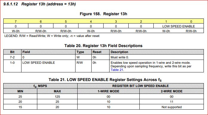

    What sampling rate are you using for the ADC clock? Is your application using any ADC power down modes? What SPI writes are being performed before CLKin is applied?
    If the sampling clock is below 25 MSPS, the Low Speed bits should be set (with respect to 1 wire or 2 wire mode) in accordance with the datasheet (see pic below).
    Dan
  • Hi Dan,
    the SPI is programmed as:
    adc.writeSPI(dwf,hdwf,0x06, 0x01) #triggers internal software reset
    adc.writeSPI(dwf,hdwf,0x0A, 0x44) #CH A/B set test pattern 44=dig.ramp, 33=toggle, 99=0,599,2048,3496,4095,3496,2048,599,0
    adc.writeSPI(dwf,hdwf,0x0B, 0x44) #CH C/D set test pattern
    adc.writeSPI(dwf,hdwf,0x13, 0x03) #low speed enable for two wire mode
    adc.writeSPI(dwf,hdwf,0x15, 0x00) #power down channels
    adc.writeSPI(dwf,hdwf,0x25, 0xFF) #increase LVDS swing
    adc.writeSPI(dwf,hdwf,0x70A, 0x01) #power sysref
    I am using 2-wire mode to minimize the output DCLK frequency.
    In our application the ADC Sampleclock is 10MHz - I know it is below the min. frequency, but it is working (its a lab-test setup - not a product). We could try 20MHz if it would change the delay much.
    Today I investigated in the delay and measured a minimum of 10ms of ADC clock until the output data is valid - that is a problem for our application.
    What is the delay we need to expect with 10/20MHz ?

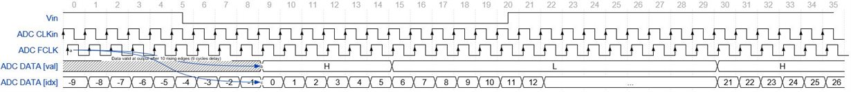

  • Hi Dan,
    thanks for keeping me updated.
    One more question I have - according to the datasheet, there are 9 cycles delay between sample taken (CLKIN rising) and FCLK data output started.
    In my application I measured 10 cycles delay - I am not sure if its just a miss-undertsanding or miss-interpretation of the definition of the 9-cycle-delay.
    Could you please provide a detailed timing diagram for this timing delay ?
    This is really missing in the datasheet.
    Thanks and best regards
    Holger
  • Hi Holger,
    The reason for a larger than 9 clock cycle delay is due to the tdpi. For 2 wire mode, this is 0.44*t_sample+t_delay. = 0.44*100nS+4.5ns which is equal to about 50 nS. While this isn't quite a full clock cycle, it does add additional delay.
    In regard to "time to valid data after first clock edge", this is not a parameter I am able to provide with the tools at my disposal, but maybe I can help provide some further understanding here. When the clock is applied to the ADC, the amplitude of the clock signal will start small and will eventually increase to its full voltage swing (due to internal capacitance and such). The ADC will start converting data at a certain point during this increase in clock amplitude, but does not output valid data until the amplitude is at the the minimum clock amplitude (200 mVpp), so this should be the threshold at which data would be valid, but then there will also be the 9 (plus tpdi delay) latency.
    This diagram from the datasheet 9.3.3.2 (figure 138) depicts how the data comes out with respect to the sampling clock. The 9 clock cycle latency is also with respect to the sampling clock, so this figure can be referenced.
    Dan
  • Hi Dan,
    I created a timing diagram (using "wavedom" - very helpful tool) to visualize the timing in 2-wire mode, please see below.
    Regarding your explanation above on the increasing amplitude of the internal clock - if it is as you descibe above - this would imply, that there is no clock, and thus no DCLK / FCLK if no input clock is applied. But this is not true.
    If no input clock is applied the internal PLL runs freely and is producing random output data at DATA, DCLK and FCLK. This means (in my opinion) that the internal clocks are already running but are not synchronized to any external clock.
    At the time an external clock is applied to CLKin, the internal PLL needs to synchronized and lock - I observed that this takes about ~1ms. After this ~1ms the FCLK is in sync with the CLKin. But still it takes more than ~10ms until valid output data is available.
