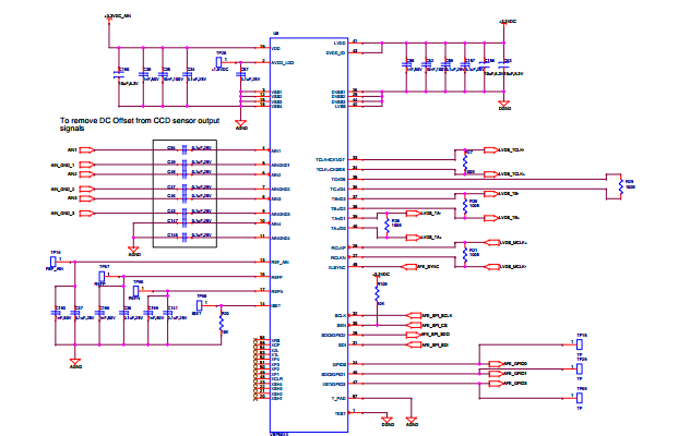

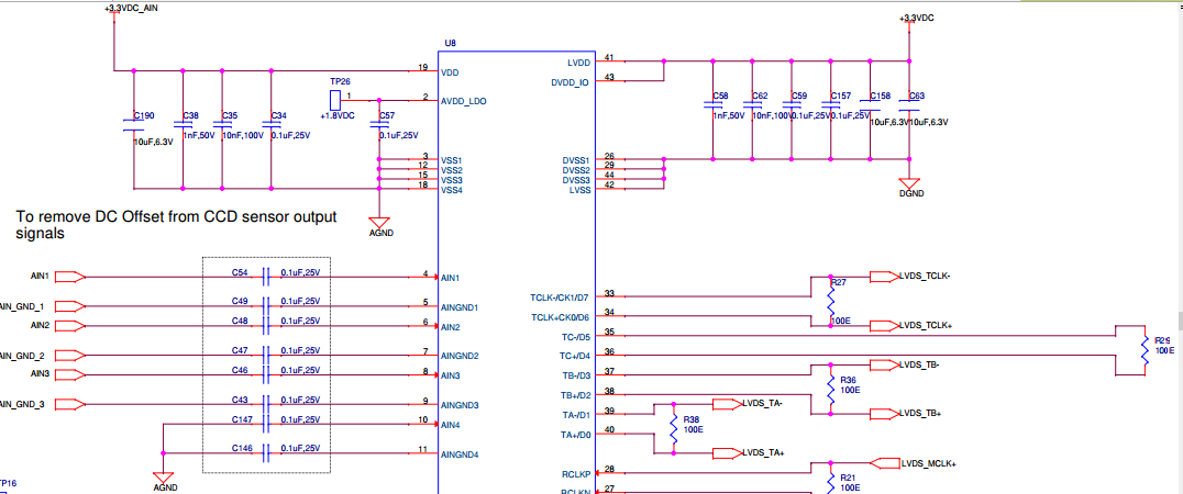

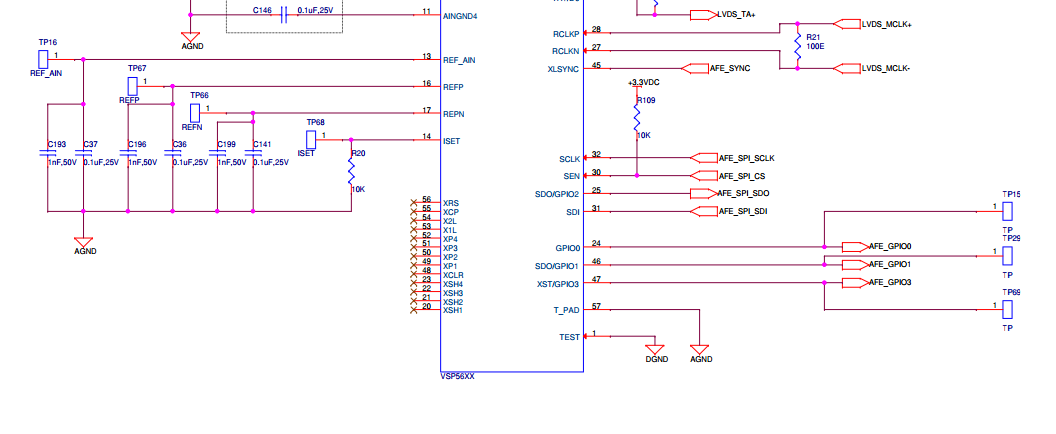

VSP5610: in one channel not getting 3 count
Part Number: VSP5610
I have conifigured Afe in cds mode and i have ground my input signal.In 2 channels i am able to see 3 counts. while in other in one channel i am able to 150 counts why?
My AFE Configuration settings are
I have configured Mclk of 1 Mhz.
Clamp mode is pixel clamp
Reference and clamp level selection is internal Reference 2.2v.
channel polarity-CCD
And counts set in SHP AND SHD ARE
SHP_CH 1&2_Rising edge-6
SHP_CH 1&2_Falling Edge-14
SHD_CH1&2_Rising Edge-31
SHD_CH1&2_FALLING-38
SHP_CH 3&4_Rising edge-7
SHP_CH 3&4_Falling Edge-14
SHD_CH3&4_Rising Edge-32
SHD_CH3&4_FALLING-38
Gain=1
I have attached the schematic picture of Afe.
