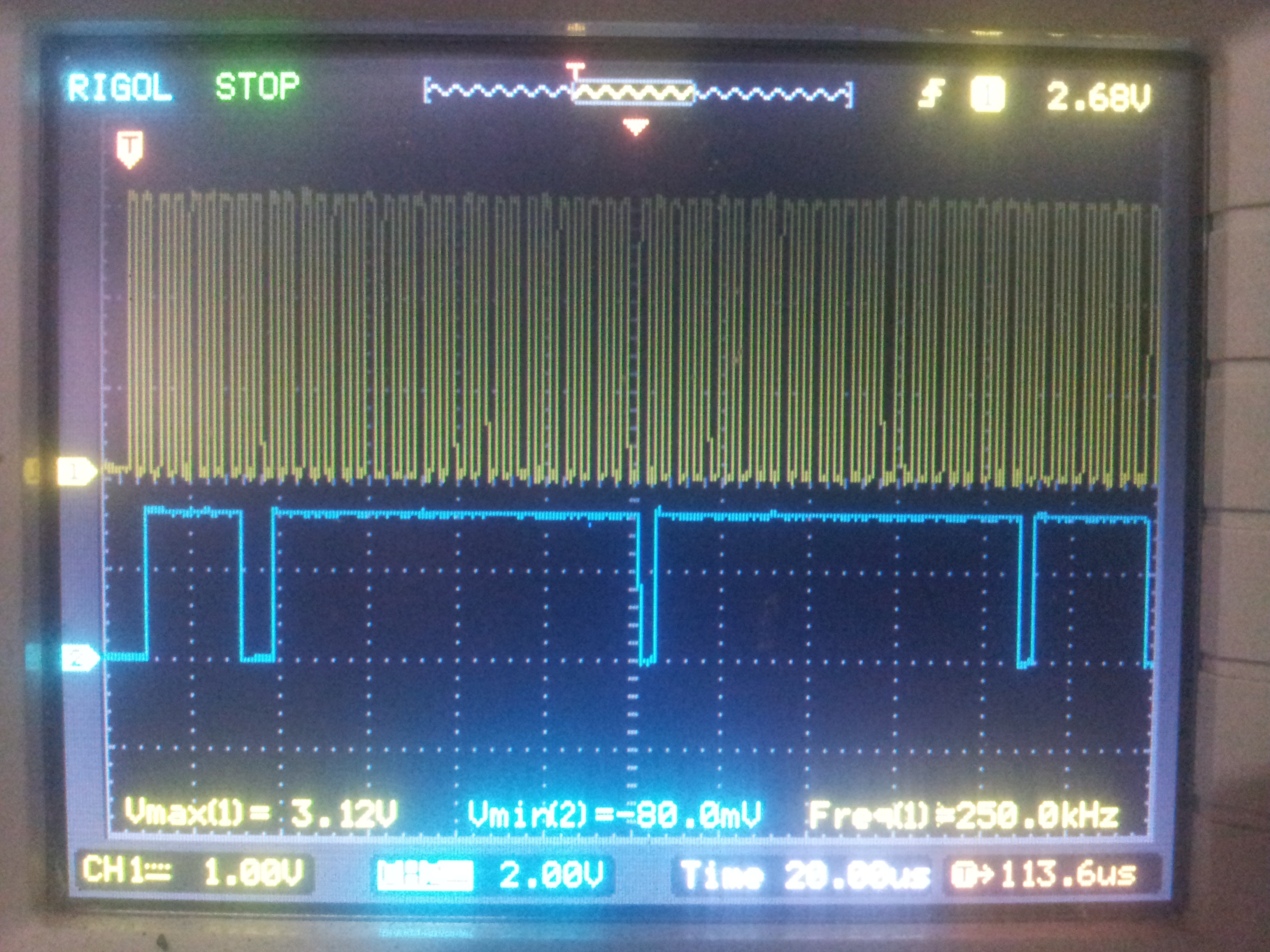

Trying to read the temperature off the internal diodes in the ADS124S08, at a loss what to do next, unable to read valid data.
What I am doing:
* Pull down RESET
* Release RESET
At this point, I can read the register contents, they match the default register values defined in the datasheet.
* Wait for RDY bit
* CLear FL_POR
* Enable the Temperature sensor (Reg 0x09)
* Enable PGA (Reg 0x03)
* Limit PGA gain to 4 (Reg 0x03)
* Send START OPCODE
* Set START Pin High
* Check DRDY
* Send RDATA OPCODE
* Read Data out
I get blank data at this point.
I can confirm the same data on the SPI bus (SCLK and MISO lines). Do I need to do anything more setup, to get valid data from the temperature sensor ?
Have gone through the datasheet, looking for specific setup for the temperature sensor. I couldn't find any.
Can someone please tell me what I am doing wrong ?

  • Hi Manu,
    You must have a valid reference voltage to make the conversion result.  It appears that you are using the default settings for the Reference Control register (0x05).  The default setting is to use the REF0 input pair which you have as unconnected in your schematic.  On page 78 of the ADS124S08 datasheet the configuration bits are shown for the reference.  The default setting is 0x10.  Try turning on and using the internal reference by writing the register contents as 0x1A.
    Bob B
  • Hi Bob,
    You were spot on. Enabling the reference did the trick. Regarding the default setting is to REF0, I will try to keep in my head. Thanks!

    I was able to see the change:
    but something went wrong, after that. I cant seem what though.. The reads just stopped
    checking everything as to what went wrong..
    Manu
  • Hi Bob,
    That was some loose cables. Sigh!
    Manu
