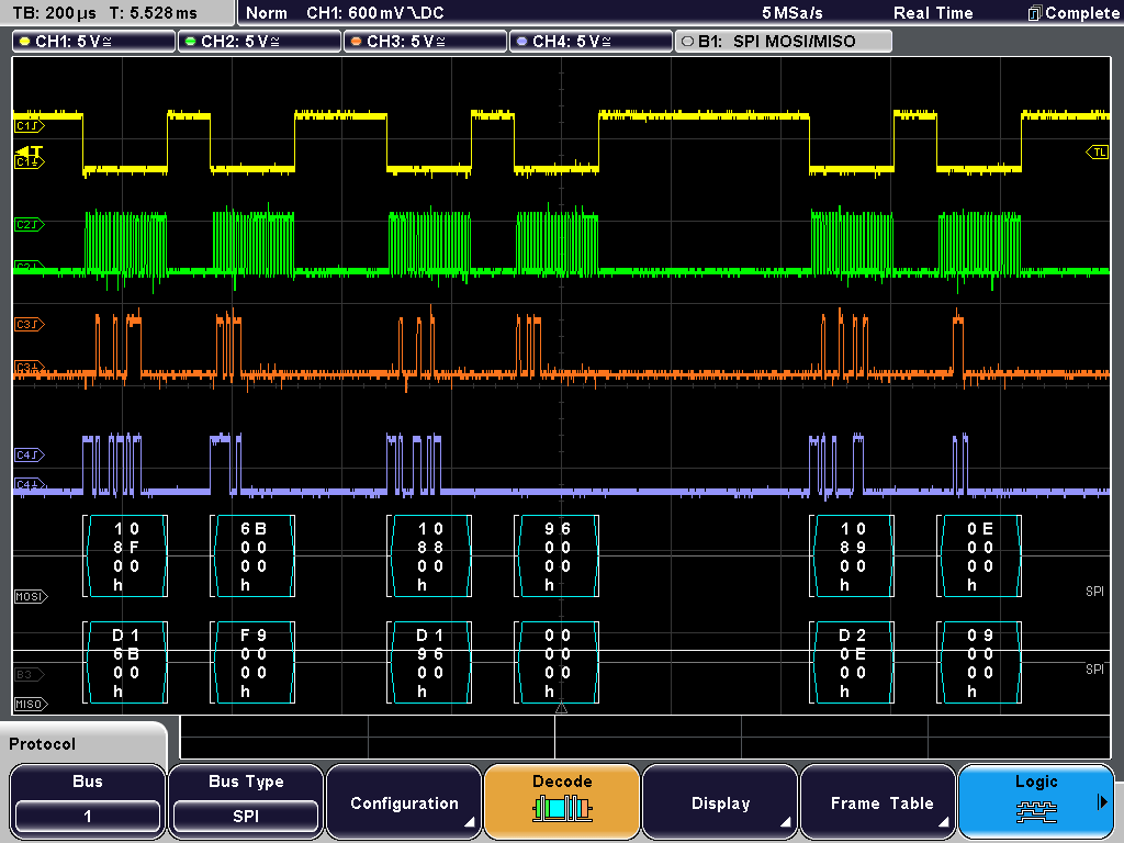

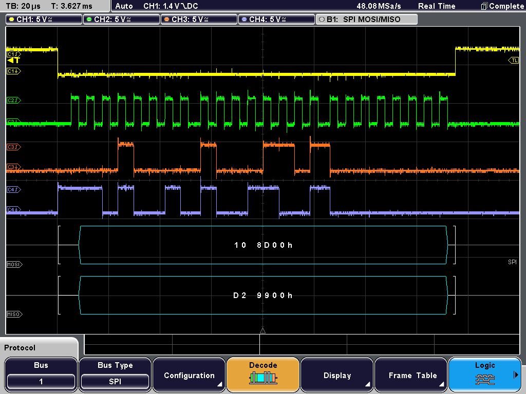

I'm trying to test the ADS8168 with Custom Channel Sequencing mode, which for some reason doesn't work.
I'm using a custom board with an ADS8168 on it and another custom board with an ARM processor on it, controlling the ADS8168 via SPI.
Manual mode and auto sequence mode works already very fine, so I think it's not a problem with the timings nor with the SPI mode (we're using SPI-01, by the way).
I'm trying the following configuration:
- Set ADS8168 to custom channel sequence mode
- Define channels 0 and 1
- Set sequence start to index 0 and end to index 1
- Start the sequence
- Discard first answer
- Read two answers

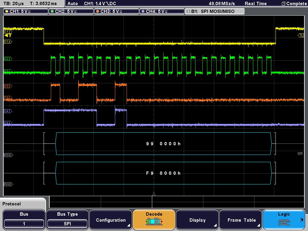

The second scope screenshot is only to see the second answer.
See the decoded SPI messages on the bottom of the scope screens.
Analog input values:
AIN0: 3.359V
AIN1: 0.343V
So, the first answer seems ok - the ADC value is 0xD1CE. However, the second answer is about the the same value, which is not ok. It seems the multiplexer doesn't switch the channels (checked with scope on ADC-INP), everything else seems to be fine.
Any ideas what could be the problem here?
Kind regards,
Markus

  • Reading out the used registers, I get the following:
    ADS8168_REG_DEVICE_CFG (0x1C) = 0x03
    Register 0x8C = 0x00
    Register 0x8E = 0x01
    ADS8168_REG_CCS_START_INDEX (0x88) = 0x00
    ADS8168_REG_CCS_END_INDEX (0x89) = 0x01
    ADS8168_REG_SEQ_START (0x1E) = 0x00
    The values seem to be correct in my eyes.
    This is before starting the sequence, so the value for the ADS8168_REG_SEQ_START seems to be correct, too.
    Any ideas what could be missing?
    Kind regards,
    Markus

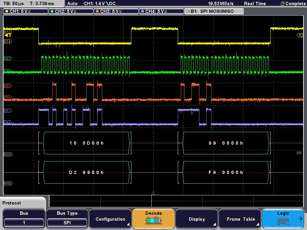

  • Hi Markus,
    You did not misunderstand; I was too quick with my previous answer and overlooked the do-not-write bits.  Use the SET bits and CLR bits commands when writing to registers with read-only (do-not-write) bits.
    Based on what you have provided, I do not think you are missing anything. Registers = 8D, 8F, 91, 93, 95, 97, 99, 9B, 9D, 9F, A1, A3, A5, A7, A9, and ABh should read default value of 01h, not FFh.

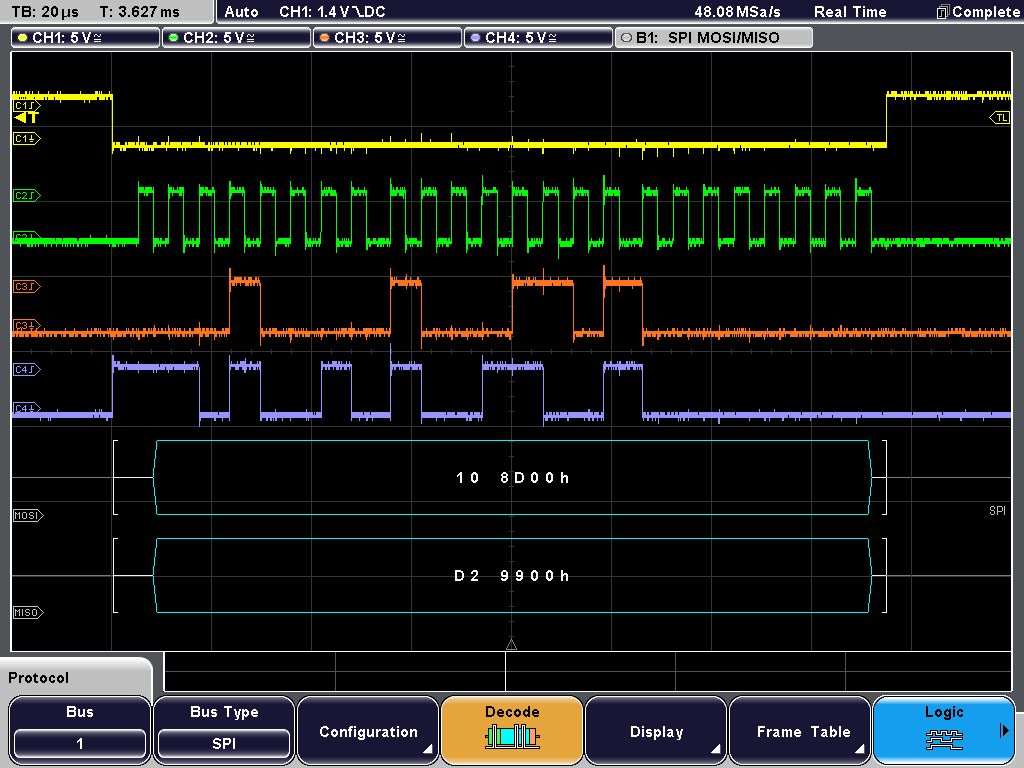

    I think your timing and commands are correct, but to make sure on the timing, can you send a zoomed version of the read frame for register 8Dh?  I want to check all of the setup and hold times.
    Assuming you are meeting all timing requirements (I do think you are since you can get the other channel sequence modes to work) , please give me a few days to follow-up with the design team.
    Keith
  • Hello Keith,
    here are the "zoomed-in" scope images for the access to the 0x8D register:
    Great if you can have a look at it with the design team!
    Kind regards,
    Markus

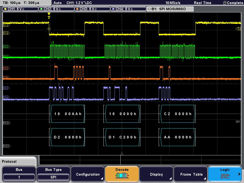

    I am not sure if this is needed, but to test the interface, please try the following (if you are not already doing this).
    1) write 0xAA to address 0x00 to enable register write access.
    2) Write to address 0x00 - using both SET_BITs and REG_WR opcodes, and then read back register to verify.
    Keith
  • Hello Keith,
    Writing 0xAA to 0x00 register (using REG_WR)
    Writing 0xAA to 0x00 register (using SET_BITS)
    Seems ok to me.

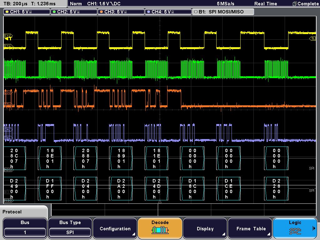

  • Hi Markus,
    I spent some time today looking at the EVM and it does appear that the REPEAT_INDEX_m registers default to 0xFF, not 0x01.  These are full 8 bit registers, so you need to write to all 8 bits and update from 1111 1111b to 0000 0001b.  You can do this using the WR_REG command, or first clearing all bits using the CLR_BITS command and then setting the desired bits.
    For example, to update register 0x8D to 1:
    08 8D 01h  (WR_REG)
    OR
    20 8D FFh  (CLR_BITS)
    18 8D 01h  (SET_BITS)
    Also, you are already doing this correctly, but do not set the SEQ_START bit until all of the other registers have been properly configured for Custom Channel Sequence mode.  I inadvertently did this using the EVM, and then could not get the channel sequencing to work correctly.
    Keith
  • Hi Keith,
    thanks - this solved my problem! Custom sequence is running now!
    So, maybe you want to put/correct this information in the data sheet (and eventually also provide a working example) in order to help other developers get it up and running more quickly.
    Kind regards and again many thanks,
    Markus
