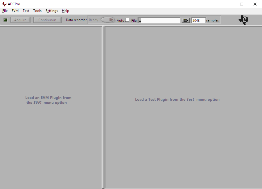

  • Hi Carl,
    ADCPro should initially look like this when it starts:
    And you do not need to have the board plugged in to initiate the load of the plugin.  You should see this screen if you attempt to load the plugin without the board connected:
    Bob B
  • I do not see this screen! Just the one with error codes! May reload the software tonight!

  • The board is up and running now!
    1. Loaded ADS1220EVM-SW-installer software on a Win 7 laptop that already had ADCPro.
    2. Loading this software removed the TUSB3410 driver.
    3. Ran ADCPro and loaded the ADS1220EVM board. No board connected to the USB port.
    4. This ran correctly! Looks like the screen above. Closed ADCPro and reopen APCPro and then connected the ADS1146 board. Rescan did not work. Checked device manager and the USB driver was not there. Shut down laptop. Removed the board from the USB port. Booted the laptop.
    5 Reloaded the TUSB3410 driver.  Ran ADCPro. Connected the ADS1146EVM-PDK and it connected! Also updated the firmware!
    6. Having fun now!
    7. I guess I needed to reload the driver when I reloaded the ADCPro & installer software. The installer never loaded the USB driver for me!
    Thanks for all your help!
