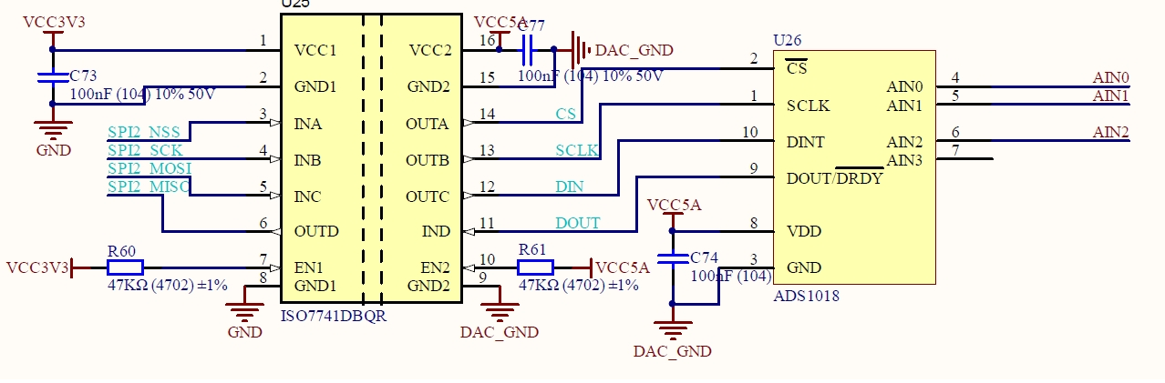

I have a communication issue with ADS1018. The symptom is the DOUT data is not the same with DIN data on CONFIG MSB& CONFIG LSB when using 32-bit data transmission cycle. Here is DIN data: 0x05,0x8b,0x05,0x8b, but DOUT data: 0x80,0x00,0x05,0x89.
Could anyone suggest the possible cause?
Here is schematic.
