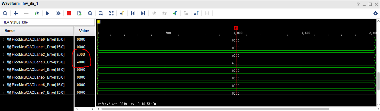

  • Hi,Jim
          Thanks for your timely reply,we test DAC38RF82 with your attached register settings;
    But,there is no data output;Sync always from High to Low.
    We read register  0x66 and 0x67;
    (1)register  0x66 is 0xc000;frame alignment errors;multiframe alignment error
    (2)register 0x67 is 0x4000; frame alignment errors.
    Could you give me some advices to solve these problems?
    Wong

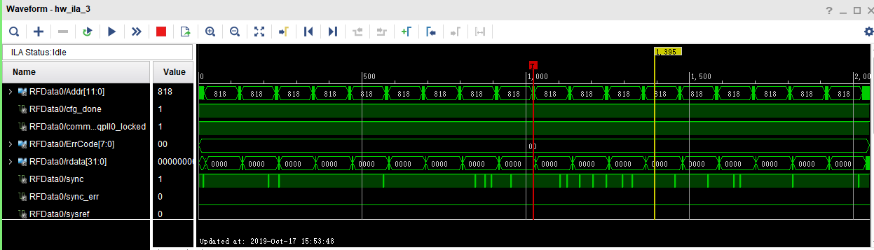

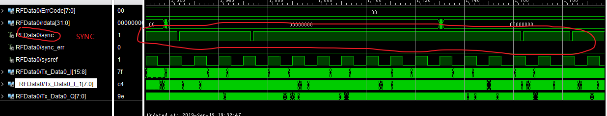

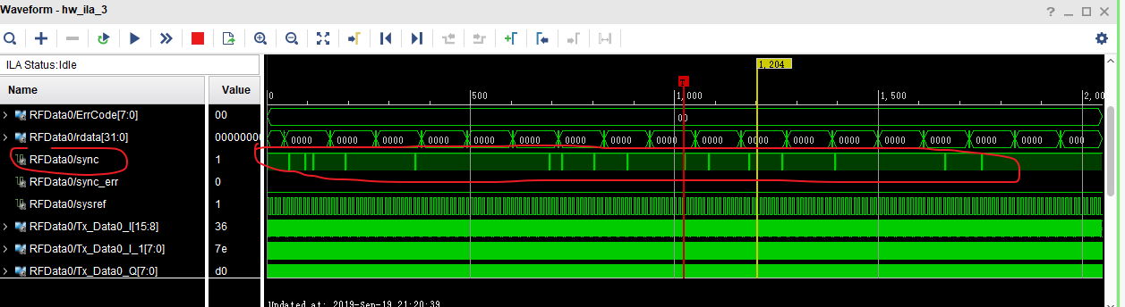

  • Hi,Jim
          Thanks for your timely reply;
    (1)SYNC is toggling;screenshot as below
    (2)we use DAC_RX3 as JESD lane 0,DAC_RX2 as JESD lane 1
    (3) my register setting is attached as below
    22210_mod.cfg
    Wong

  • Hi,Jim
           I add some thing, we use all sysref  0x124=0x0010;0x15C=0x0001;sync is toggling;screenshot as below
    Wong

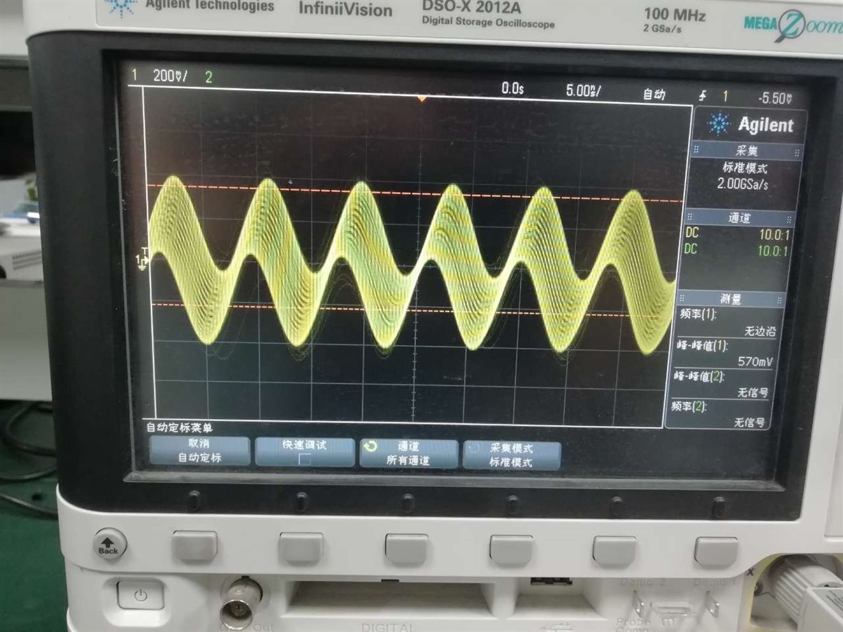

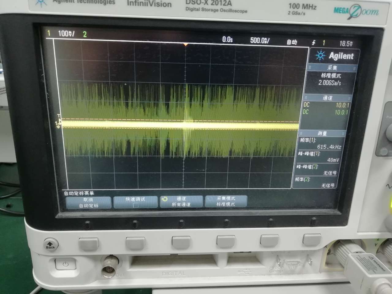

  • Hello,Jim
       Today,we do the NCO only testting,we setted NCO freq =12MHz,We use an oscilloscope to check the output of the signal.
    but,We find a Puzzling problem.
    (1)In the mode LMFSHD=22210;We change register 0x127 to 0x1144;we use"sync_out from JESD" to sync NCO instead of sysref;but there is no data output
    (3) Some time ago,We tested in the mode LMFSHD=82121 ,we setted NCO freq =12MHz; we also set register 0x127 to 0x1144; Using "sync_out from JESD" to sync NCO ;DAC is working good;we can get NCO output 12MHz waveform
    We compare the two modes register setting,we can't find any discrepancy.

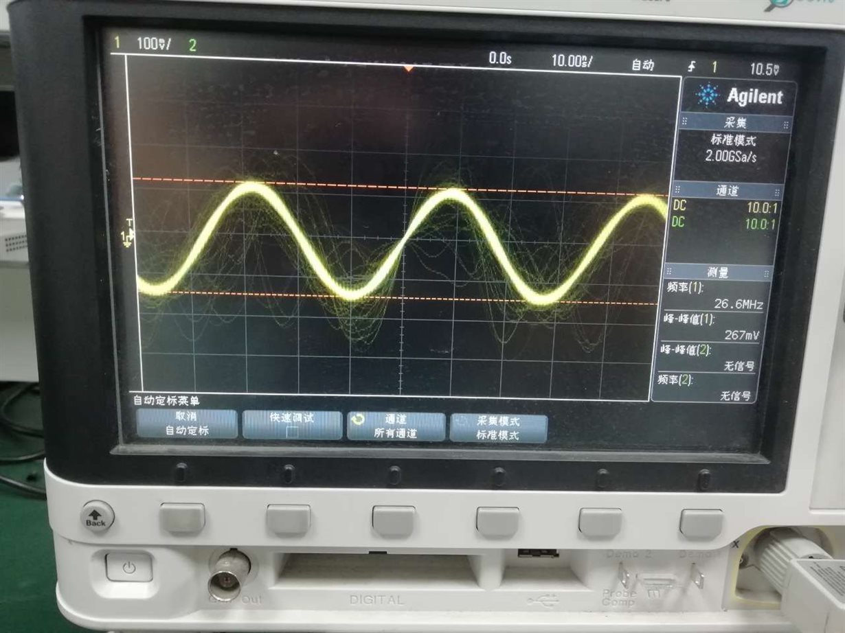

    (1)we set NCO=27MHz, SYSREF=10MHz; Changing register 0x127 to 0x2222.DAC use the sysref sync NCO;we also set bit 13 of register 0xC to a "0" in page 1 , 0x10C=0x0622;
    when we download firmware ,there is no data out;

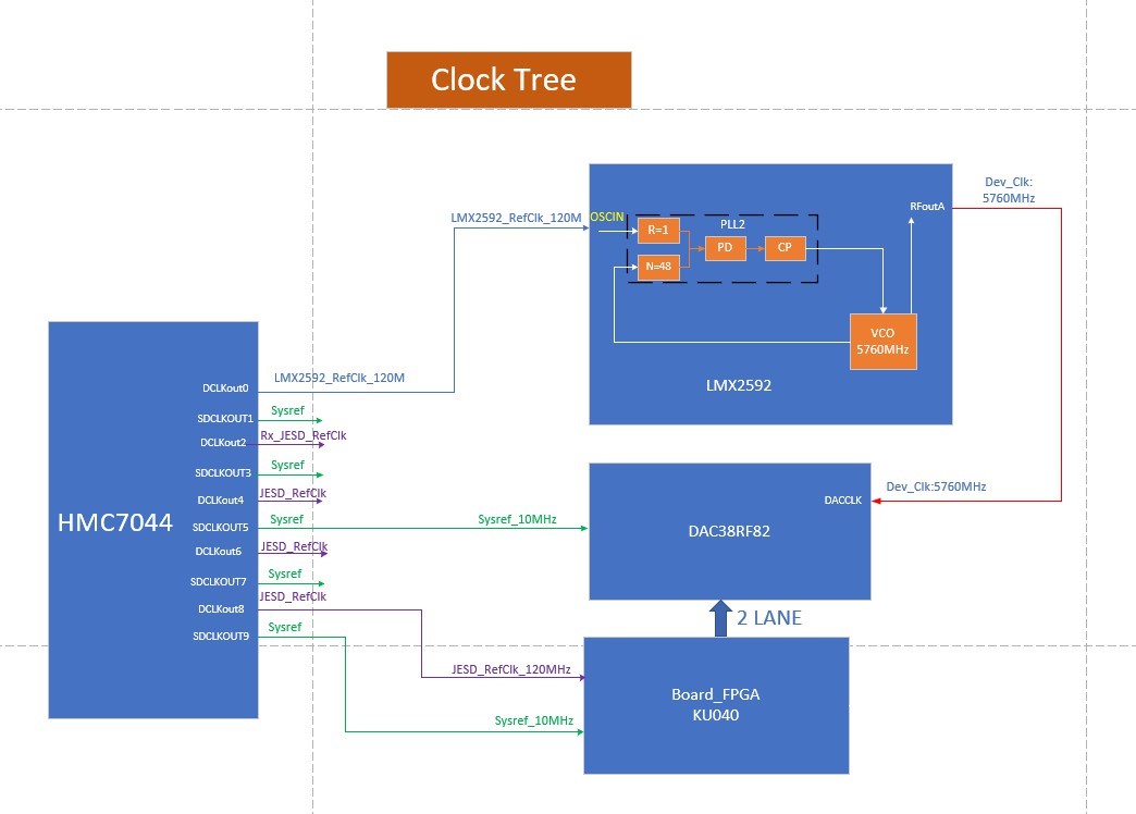

  • Jim,
    our clock tree is as below:
    (1) The chip HMC7044 generate reference clk and sysref to chip LMX2592 ,DAC38RF82, FPGA.
    (2)All output clocks of  Chip HMC7044 have the same phase .
    (3) HMC7044 Provide LMX2592_RefClk_120M to LMX2592 to generate synchronized clk Dev_Clk 7200M to DAC as DACCLK.
    (4) In my opinon , LMX2592_RefClk_120M and sysref_10M is synchronized, Dev_Clk 5760M is deterministic with the sysref_10M.
    Wong

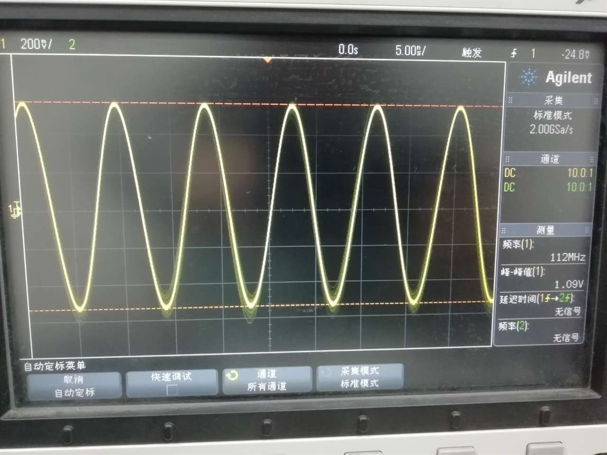

  • Hi,Jim
        I am sorry to bother you again;Not long ago, we thought the problem was solved. But recently discovered new problems when doing  further testing.
    Although DAC can output the correct waveform,But sometimes the sync is always toggling;
    For example:
    FPGA DDS module generate 100MHz baseband signal;NCO=12MHz;
    Result:
    (1)DAC output correct waveform 112MHz;
    (2)but,sync is always toggling
    (3)Reading 0x166 and 0x167 register;the value is 0xC000;it means"multiframe alignment error and frame alignment error "
    Wong

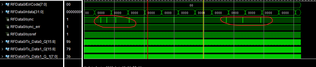

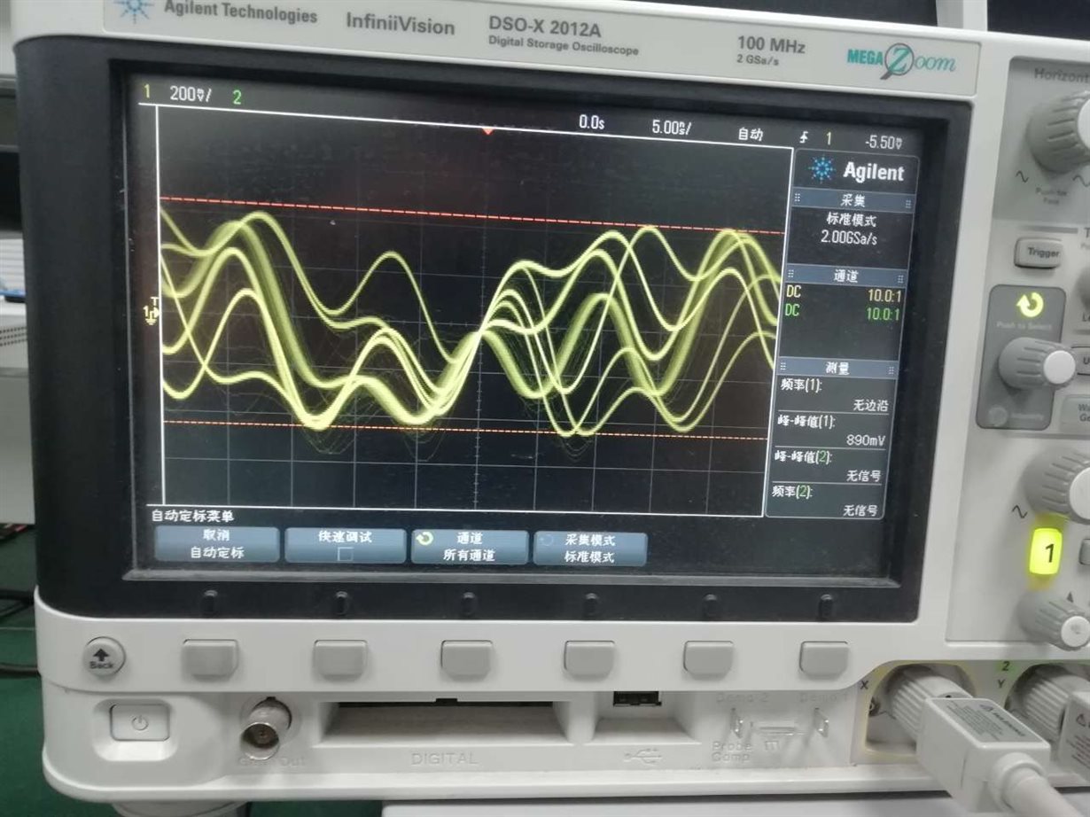

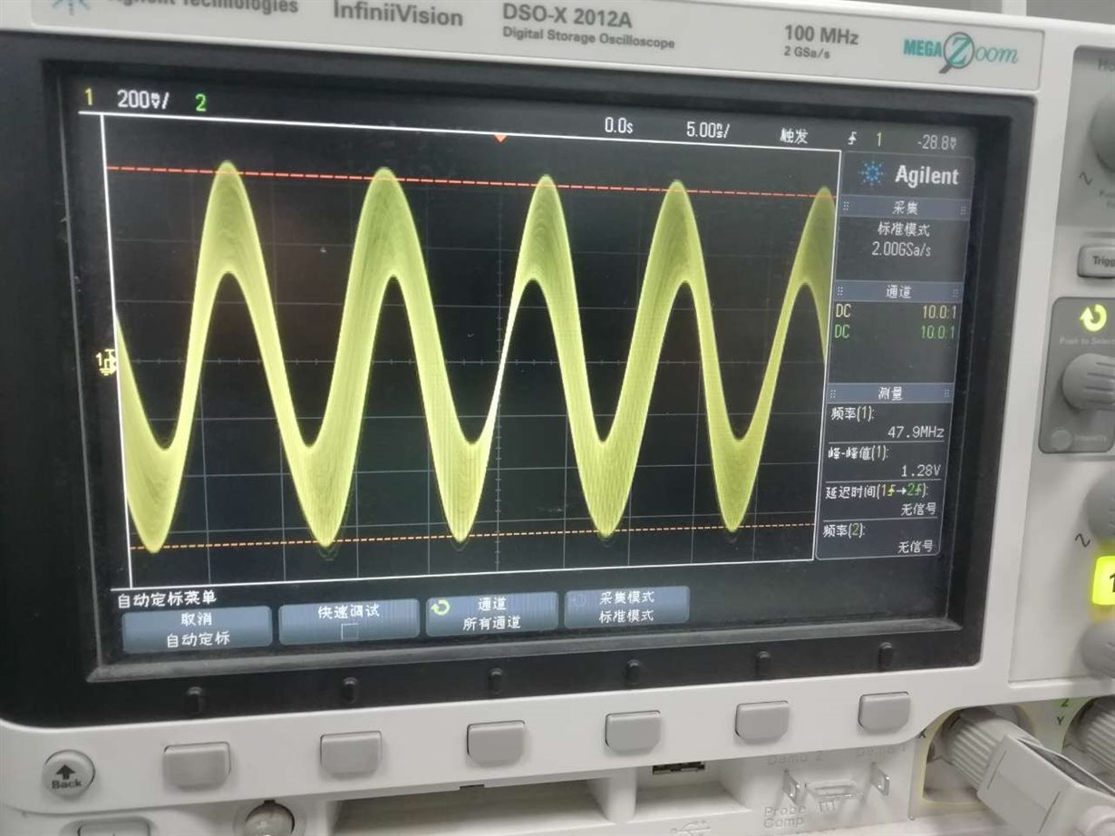

  • Hi,Jim
    Thanks for timely reply,Today, I did the following test.
    1.I change K from 24 to 32,RBD=31;from 24 to 20,RBD=19;but, SYNC is still toggling
    2.I turn off SYSREF after the link is established,there is no effect on DAC output
    3.moving the SYSREF rising edge with respect to the DAC clock;some times ,DAC output  distortion signal
    sometimes,DAC output correct signal and the sync is toggling.
    Wong

  • Jim,
    Thanks for your reply;
    1.Are you making these changes in the FPGA as well? Both the DAC and FPGA must have the same value for K?
     Yes,Both the DAC and FPGA  have the same value for K
    2.turn off SYSREF after the link is established,Is the DAC output valid? Is SYNC toggling in this case? Is toggling less or more?
    (1)Turn off SYSREF after the link is established,DAC output valid
    (2)SYNC is toggling in this case;
    Before turn off SYSREF;
    After turn off SYSREF;

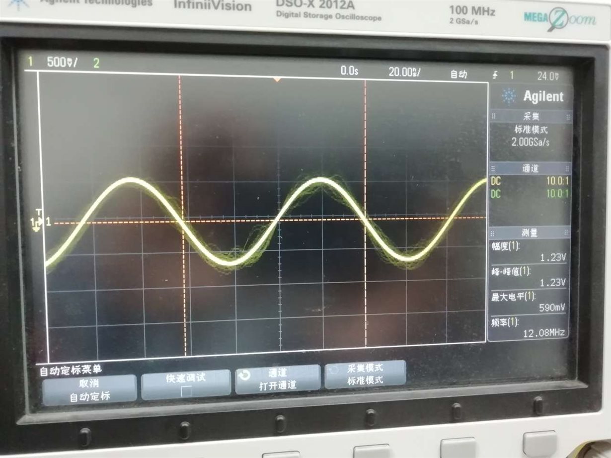

    (3) I run the NCO test per your attached document,I find the sysref problem; set sysref=10Mhz,NCO=12MHz
    Set address 0x27 in page 1 and 2 to 0x2828 to use SYSREF as the SYNC source. SYSREF is present, But,the DAC output is a stable NCO tone;
    moving the SYSREF rising edge with respect to the DAC clock,But,the DAC output is still a stable NCO tone
    Wong

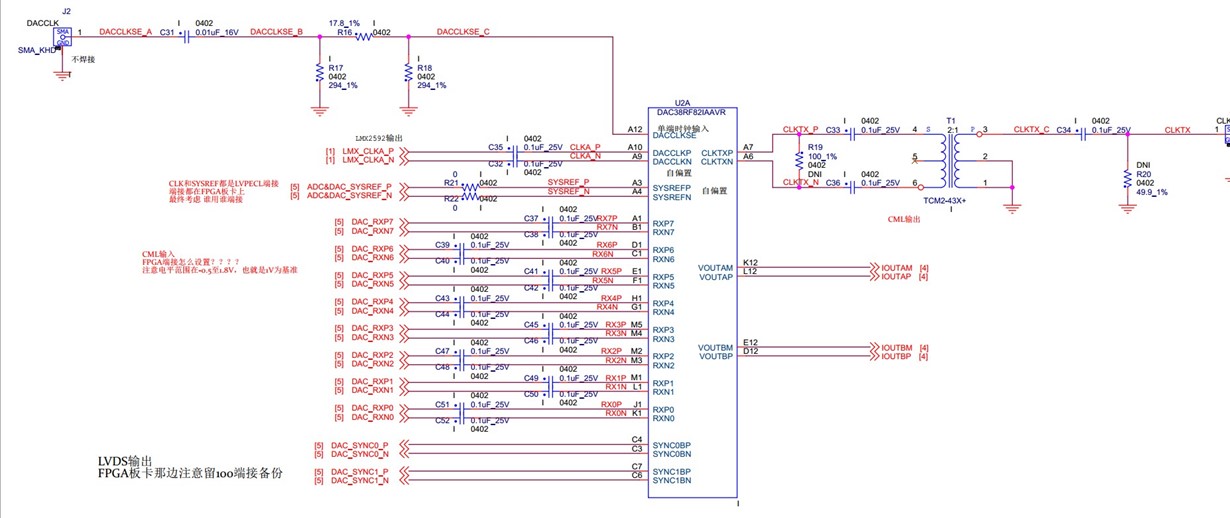

    Can you send your schematic? It appears you have an issue with the SYSREF timing. Is this signal AC or DC coupled?
    Jim
  • Jim,
    Here is our schematic
    Wong

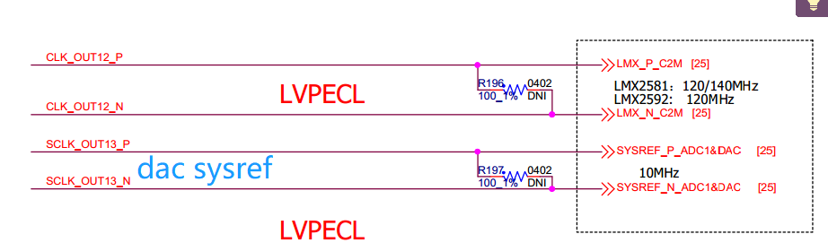

  • Wong,
    I need to see what is driving the SYSREF inputs and what standard these signals are driven as (LVPECL, LVDS, ect…).
    Jim
  • Jim,
    the sysref is LVPECL  INPUT
    In addtion, the same custom board is working good In the mode LMFSHD=82121;SYSREF can reset NCO in many tunes;Sync  is not toggle
    Wong
  • Wong,
    The SYSREF test is independent of the JESD interface. You should have failed this in both cases or passed it in both cases. Sync status is not irrelevant with this test.
    Ii appears from your schematics the interface is DC coupled. There is a good chance the SYSREF is not set to the correct common mode voltage of 0.5V. Can you check this on your board? You may want to replace R21 and R22 with 0.1uF capacitors to AC couple this interface and provide the proper common mode voltage.
    Jim

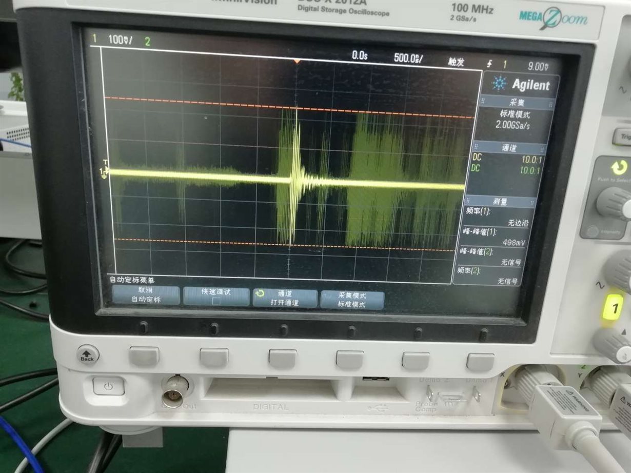

  • Hi Jim,
    I am very grateful for your patient guidance.
    1.we provide a dacclk = 5760MHz, and a continuously SYSREF = 12MHz, load the DAC with the registers your attached. After doing this, Seeing only one tone out at 17MHz from DACA.we try to adjust register 0x424 setting;sysref Centered on phase φ23 or Centered on phase φ34 or Centered on phase φ41;but it has no effect;
    2.Then we change a continuously SYSREF = 7.5MHz,many tones coming out of DACA.
    Wong

     clear registers 0x04 and 0x05 by writing a 0x0000 ;then  I read them back;0x04=0x00DB;0x05=0x013F
    settting sysref=10MHz,NCO=12MHz;Seeing only one tone out at 12MHz from DACA

    If you are using the same data input mapping as the TI board, in register 0x04, bits 2 and 3 should be "0". You are reporting a "1" in bit 3 which indicates you have no data coming in on RX3. I would double check the data coming out of the FPGA.
    For a possible SYSREF issue, try enabling the sysref alignment logic, by setting bit 0 of general configuration register 0x24 to a "1". When using this mode, you can make adjustments to the SYSREF timing using bits 13:12 and 15:14 of this same register. You can also monitor alignment statistics as well. See section 8.3.10 of the data sheet.
