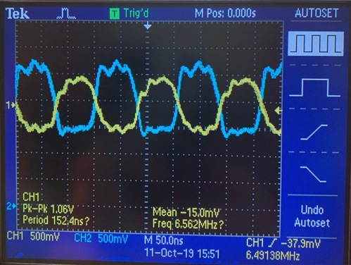

Hi, I'm trying to set up ADS1299 from an Arduino UNO board. I'm currently using the OpenBCI C++ code posted on Github.
I tried to follow the initial flow at power-up (p. 62 datasheet), but I can't seem to obtain the proper SPI signals.
- The clock is set to 4Mhz, instead I get a 6Mhz signal
- DIN shows a periodic signal during RDATAC
- All SPI have different voltage offsets
Here I present the oscilloscope diagrams.
SCLK with DRDY:
SCLK with DOUT:
SCLK with DIN: shows the same signals, but with different offsets.
In addition, when I read the registers every few seconds they seem to change in random manner:

I'm using a QFP64 TQFP64 to DIP64 Socket, a breadboard and jumpers.

I tried changing the power source but I encountered similar problems. They also seem to happen during the initialization of the ADS but before the Serial.begin line which is very confusing. Could it be that I burnt out the chip or is it simply an SPI problem?
I appreciate your help!
Thanks!
