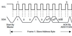

  • Gandhali,
    A colleague just noticed that you've contructed the address read/write incorrectly. The I2C address is 48h, but that is the upper 7 bits of the write. In your address, you use 48h as the byte and then and OR it with 0 or 1 for a write or a read. For the I2C address, you should 90h and then OR it with 0 or the 1 for the write or read. From the timing diagram, you can see it here:
    Joseph Wu
  • hello Joseph,
    Thank you for your suggestion.
    I have written slave id 0x90 as per your suggestion but still its not responding.
  • Gandhali

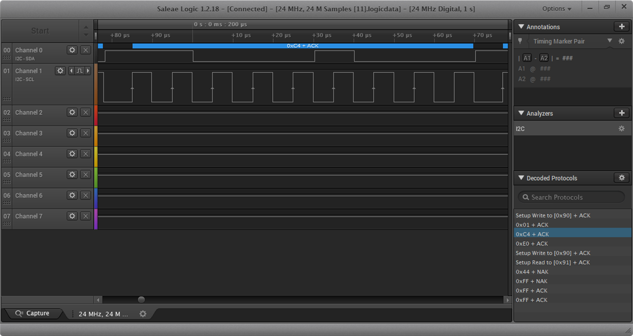

  • Hello Joseph,
    I am uploading my updated code and now I am able to catch waveform on logic analyzer but still I am not getting ADC value through ADC.
    I have connected my input between AIN0 and GND.
    So please go through my code as well as shot from logic analyzer and suggest some solution.

  • Gandhali
    Thanks for the logic analyzer photos, I think they could help a lot. Because I also have a Saleae analyzer, can you save the .logicdata file? You should be able to post it back here if it's not too large.
    Looking at the I2C exchange, I think you've set up the read wrong. It starts with a 90 write, then a 00 for the conversion register pointer, then 91 for the read for the last two bytes.
    Joseph Wu
  • Joseph,
    We have observed waveform on logic analyzer using code in arduino.
    There was problem in my START and STOP condition.
    So my issue is resolved.
    Thank you for your support.
