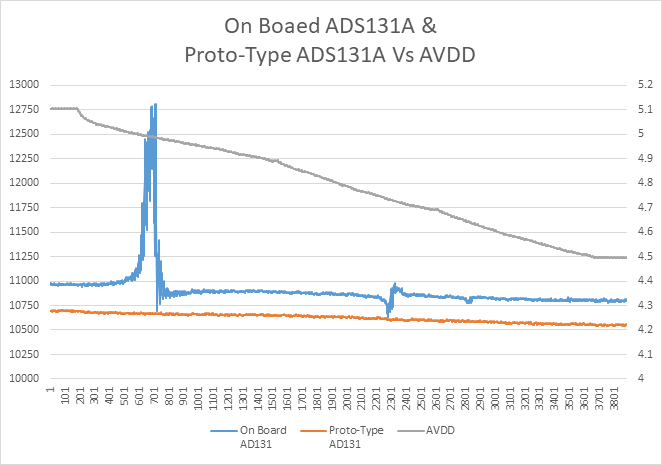

Unfortunately, there were fluctuations of up to 1000 counts or more in the acquired data under certain conditions.
That is, when the voltage applied to AVDD is changed, the acquired data varies in the voltage range around 4.9V.
Even when the prototype A / D is connected in parallel and operated simultaneously,
The problem does not occur in the prototype A / D, but only in the A / D on the substrate side.
(If the prototype A / D is connected in parallel, the variation will be smaller and the voltage range will change slightly.)
Therefore, it is not a problem such as oscillation in the analog part,
I think there is a problem with A / D.
The graph below shows the A / D value while lowering the AVDD voltage manually.
(A / D on printed circuit board and A / D on prototype board.)
It can be seen that the problem occurred when the AVDD voltage was around 4.9V.
There are minor symptoms at other voltages such as around 4.7V.
The power supply voltage and the reference voltage were also examined by simultaneous capture, but no fluctuations that could be causal were found.
I was worried about mistakes in digital data, and I added a CRC.
There was no CRC error.
Is there a problem with routing the printed circuit board pattern? I think, but I would appreciate any advice.

    The current measurement data is obtained by simultaneously acquiring two A / D (product, prototype) data with one microcomputer and outputting them to a personal computer through serial conversion. Averaged to 20sps.
    The front-stage differential amplifier output is connected in parallel to two A / Ds(product, prototype).
    When connected in parallel, the problem symptom changes greatly (the fluctuation value becomes smaller and the voltage range moves), so the connection to the prototype A / D has a 10kOhm resistor in series to reduce the change in conditions.
    The Ch.1 compares zero input simultaneously as comparison data.
    AVdd is supplied from an external power supply for experiments, and AVdd (9 pins of product A / D) is measured with Ch.2 (display value is calculated and displayed from prototype A / D data).
    This is a continuous measurement while lowering the voltage manually.
    I think that the small change of AVdd is due to the change of current consumption (LED blinking for operation check), but I don't think there is any voltage drop to 4.7V.
    Next time, stop blinking the LED and try to collect data.
    I think that there are no time fluctuation, temperature change, vibration, periodicity, etc. in tens of tests.

    Even after these corrections have been made, the symptoms are similar. Below.
    Last time, I wrote that there was no influence of temperature etc.,
    This time, when taking data immediately after turning on the power from the cold state, the abnormal voltage range and the symptom with different data fluctuation were obtained as follows.
    The above data is taken after leaving the power on for about 2 hours.
