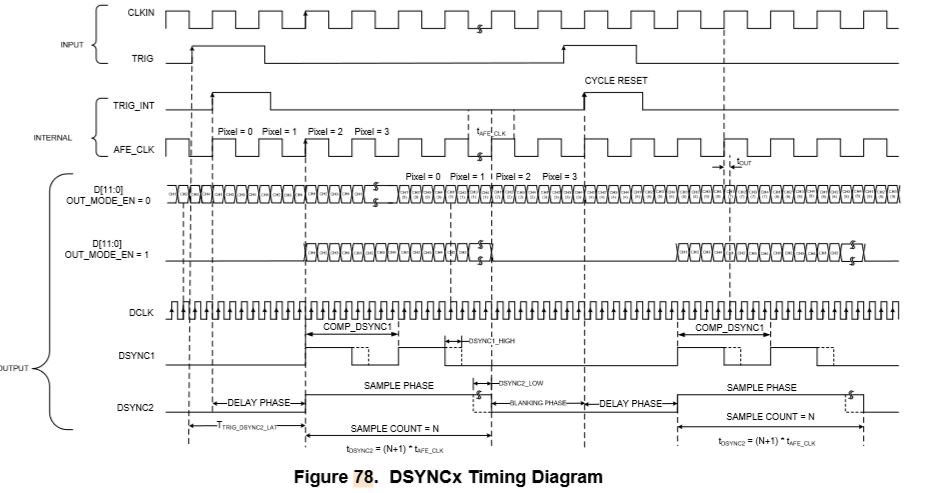

customer use AFE5401-Q1 , in datasheet Figure.78 as below:
What is the mean of DSYNC1-HIGH and DSYNC2-LOW? How to configure? How to configure the Register 1A 1B ?

    DSYNC1_HIGH (reg. 0x1B) refers to the extra time (in terms of tAFE_CLK cycles) in addition to the 50% pulse high duration of DSYNC1 during the COMP_DSYNC1 period.
    The total time DSYNC1 would be high is defined by the equation: high for [(DSYNC1_HIGH + COMP_DSYNC1 ÷ 2) Mod COMP_DSYNC1]
    For example, let us say COMP_DSYNC1 = 10, DSYNC1_HIGH = 0, then DSYNC1 will be high for 5 AFE_CLK cycles.
    If DSYNC1_HIGH = 1, then DSYNC1 will be high for 6 AFE_CLK cycles and so on.
    Similarly, DSYNC2_LOW is defined as the low pulse duration during the Sample Phase. DSYNC2_LOW is defined in registers 0x19 and 0x1A.
    For example, let us say if SAMPLE_COUNT = 9 and DSYNC2_LOW = 2, then during the SAMPLE PHASE, DSYNC2 will be high for 8 AFE_CLK cycles and low for 2 AFE_CLK cycles.
