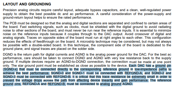

    We do not recommend that you use a higher potential for REFGND than AGND and SGND.  The REF and REFGND should not be considered a differential input, but rather REFGND only denotes that this pin has the ground return current, and should be routed to the reference as well.  We explicitly recommend that the SGND pins be connected directly to to the REFGND pins for the corresponding DACs.
    Paul

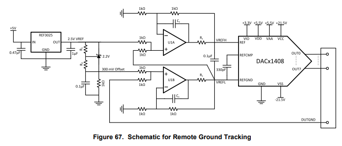

    Are you concerned about ground offset voltages? Or do you want to have an offset on the output as well?
    The DAC81408 has some REF ground offset capability.  Check out section 10.1 in the PDS.
