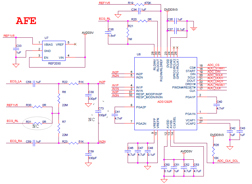

               I have a project that I need use  ADS1292 for 1-LEAD ECG application.   I only use 2 electrode to measure 1-Lead ECG without  RLD  .In this case,These electrode inputs must be AC-coupled,so how to realize the function of lead off? THX
  • Dear TI experts:
           One more question,  In this case,CMR is only 66dB,   How to improve this indicator,thx

    This question is very common for single-lead ECG applications. The electrode inputs are generally AC-coupled and biased on the ECG system circuit board. Please read through some of the related threads in our forum as well as the ADS129x BIOFAQ page.
    CMRR can be improved by utilizing the RLD feedback loop as well as by reducing the tolerances of input signal chain components. This works to match the impedance seen by each electrode input and reduces common-mode to differential signal conversion.

         I had used RLD feedback loop,but CMRR is only 66dB,can you help me ?I had try R30 or R31,but the result is the same ~66dB.

    Are you sensing the common-mode signal at the PGA outputs? This is done using the RLD_SENS register.

        My test mode is based on your recommendation,The registers have been set as required, but the CMRR  has not improved!
       Can u tell What is the typical value of the CMRR when the RLD works,Just like my project, R31 is welded,R30 is NC.THX

    CMRR performance is highly dependent on the entire signal chain. As you are only using two electrodes, it's very possible for the common-mode noise to convert to differential noise before the AC-coupling capacitors. The 22-M pull-up resistors can only help to suppress the remaining common-mode noise after the AC-coupling capacitors, but this technique cannot reduce the noise that has already become differential.
    Improving CMRR requires accurately matching the input impedances in both (+) and (-) signal paths. This impedance includes the electrode contact impedance as well as PCB traces and passive component tolerances.
