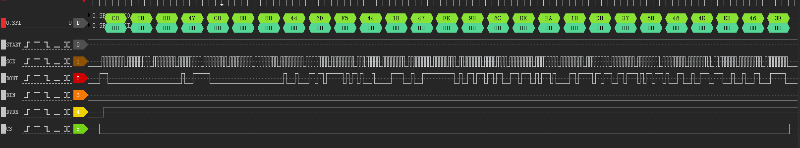

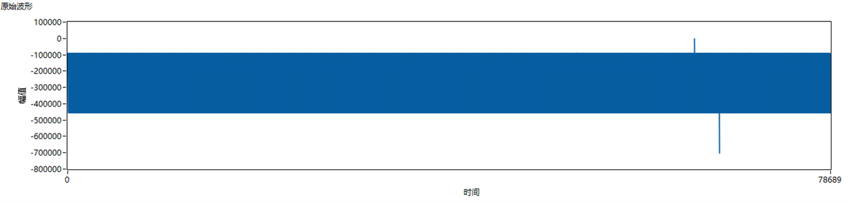

I used ADS1299 to collect 10HZ, 100MV square wave signal. After a while, my host computer showed a mutation. I used a logic analyzer to collect the SPI pin level and found that the output data of the ADS1299 was repeated. As shown below.
The channel data after the second C0 00 00 is basically the same as the normal channel data. The data output by ADS1299 is wrong. Why does this happen?

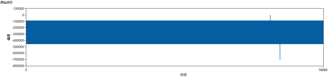

    My problem is that in the picture I posted above, there is some problem with the data output by the ADS1299, causing my data to mutate, such as the picture below me.
    I found the electrical signals collected by the logic analyzer corresponding to the mutation data. I found that the misalignment of the output data of the ADS1299 was the main reason for my data mutation. The correct data format output by ADS1299 is: C0 00 00 (24 status bits) + the first channel (24 bits) + ........ + the eighth channel (24 bits), the wrong data format I encountered Yes: C0 00 00 (24 status bits) +47 C0 00+ 00 (24 status bits appear again) and the subsequent channel value is correct. But the correct bits of the entire data are shuffled.

    I recommend that you check you SPI settings; spi settings. SCLK speed using the posts here:https://e2e.ti.com/support/data-converters/f/73/p/772058/2855202
    Also, do you see DRDY go low at any time? Using the SPI communication post in the link above, can you verify that DRDY pulses properly upon power-up?
  • HI
    I am grateful to receive your recovery。
    DRDY is reduced regularly according to the 1K rate I set.I think the ADS1299 device is normal.
    This may happen because my SPI related programs are not normal.
    I am modifying my SPI related program.
    I will contact you if other abnormal conditions occur.
