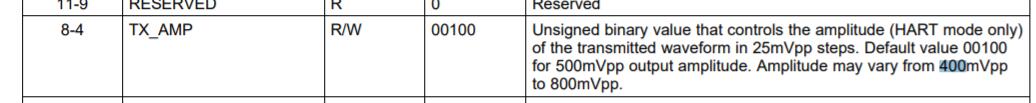

Hi there,
Is TX_AMP to set the output voltage of MOD_OUT in HART MODE? If yes, should I change the load resistance to change amplitude from 400mVpp to 800mVpp?
Thanks.
