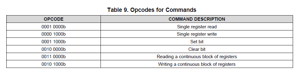

    From the screen shot provided, you are using the SET BIT OPCODE (18xh) this only allows to change one bit in the register. but you are trying to set all channels which means all bits in the register need to be changed.
    This means you need to change the OPCODE from SET BIT to Single Register Write (08xh)
    regards
    Cynthia
    The data sheet on set_bit says following
    8.5.2.2 Set Bit
    The I2C master must provide an I2C command with four frames, as shown in Figure 16, to set bits in a register
    without changing the other bits. The register address is the address of the register that the bits must set and the
    register data is the value representing the bits that must be set. Bits with a value of 1 in the register data are set
    and bits with a value of 0 in the register data are not changed. Table 9 lists the opcodes for different commands.
    To end this command, the master must provide a STOP or RESTART condition in the I2C frame.
    My understanding of this is that I can pass a bit mask and set all the bits using set_bit opcode and it actually works, when I read by the register, I do see 0xFF which tells me that all bits are set.
    Do you think set_bit opcode should not be used to set more than exactly 1 bit in the reg ?

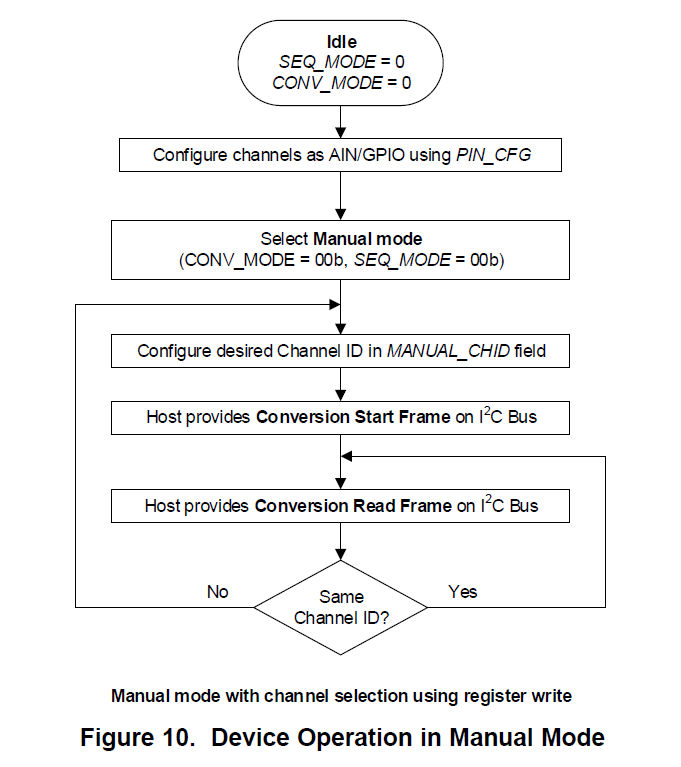

    The data output should be read at the RECENT_CHx_LSB or MSB registers. This is where the ADC data out is available.
    Also note that in manual mode you will need to initiate each conversion.
    The flow chart below shows the methodology to manual mode. If the registers are configured correctly then it seems that you are missing the read back and provide a new Channel ID and conversion start to then read the data again.
    Cynthia
  • Hello Cynthia,
     I was finally able to use manual mode flow chart to verify both fixed test pattern (0xA5) and individual channel ADC values.
