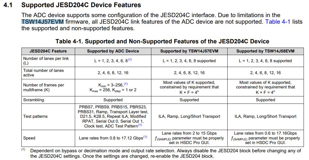

Our customer is considering ADC12DJ5200RF and TSW14J5XEVM.
Customer want a sample FPGA design when testing ADC12DJ5200RF and Intel FPGA.
Could you give me design information on the FPGA implemented in TSW14J5XEVM?
http://www.ti.com/jp/lit/ug/slau640/slau640.pdf
