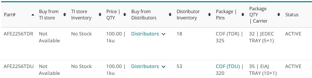

What is the difference between AFE2256TDR and AFE2256TDU?
There is no information for the TDR Package in the datasheet.

Also answered offline, but for forum proposes the TDR and TDU are just COF variants.
