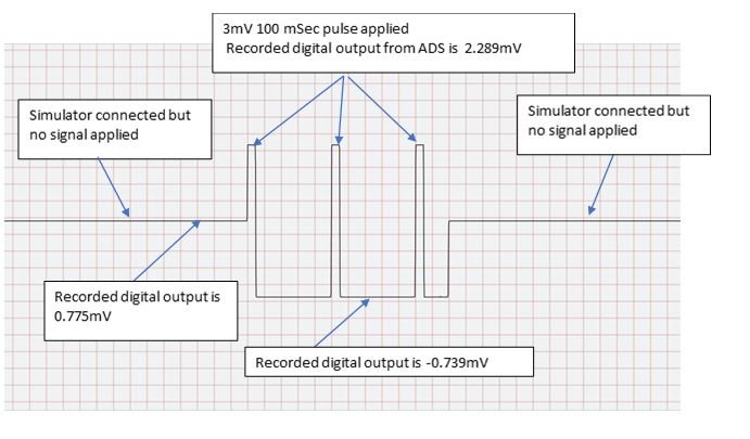

We have seen a DC shift in the signal when a rectangular pulse of 3mV is applied to the input of ADS1198. Please can you let me know what could be the reason for this DC shift and how it could be avoided.
The graph of the applied signal is shown below
  • Hello Ibtesam,
    Thank you for your post. I've received the email from your colleague about the same topic. I'll continue to work with you offline until we have a better understanding of the problem and root cause.
