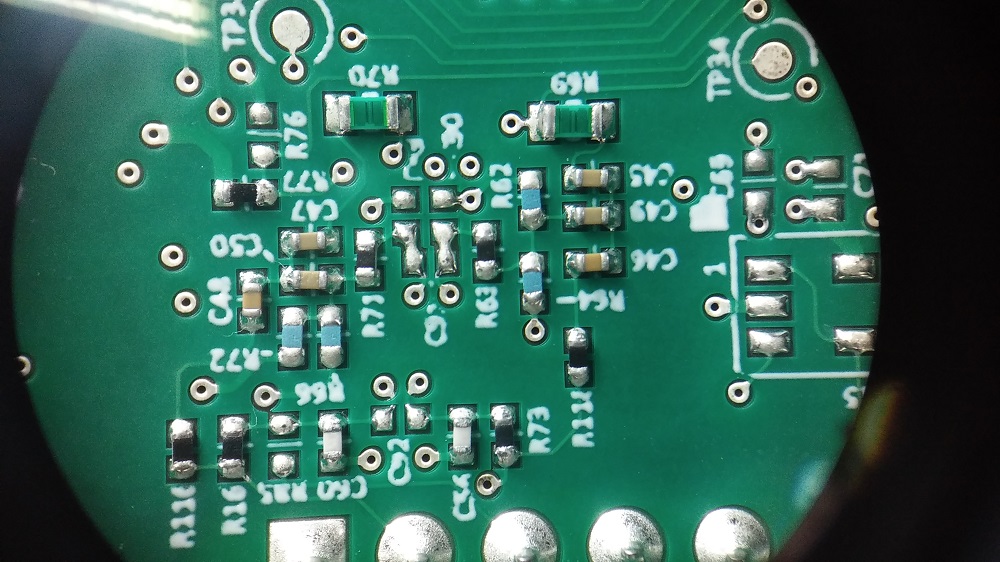

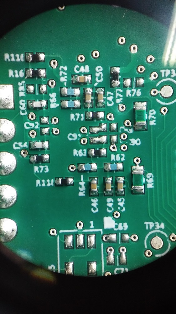

I purchased an ADS1X9XECG-FE demo KIT
This fails to test IEC 60601-2-47.

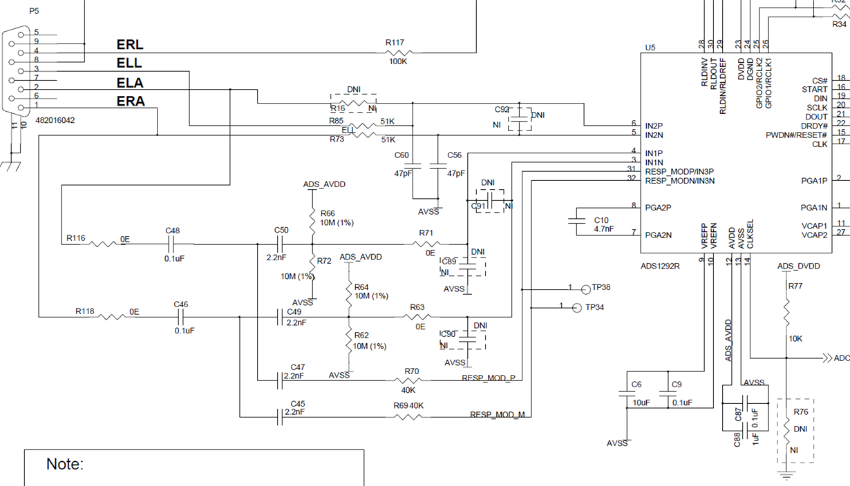

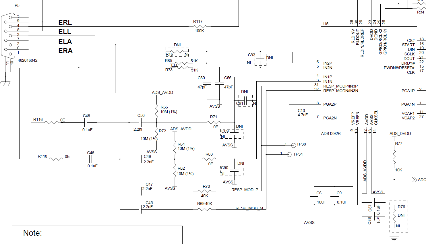

So I compared the EVK schematic and the demo KIT, but data is different
Demo KIT schematic is
R16 : DNI
R85 : 51K
But demo KIT EVK is
R16 : Mount
R85 : DNI
Please explain the changed part.

  • Hi Danny,
    Thank you for your post.
    The only difference appears to be a BOM variant. It looks like the 'R' version of the ADS1292R installs the components required for Channel 1 = Respiration (using Lead I) and Channel 2 = ECG Lead I. For the non-R version (ADS1292), you could modify the components to measure Channel 1 = ECG Lead I and Channel 2 = ECG Lead II.
    The IEC standards are system-level requirements that must be satisfied by properly designing the supporting circuitry around our ADC. We do not claim to meet these IEC standards on the device evaluation boards.
