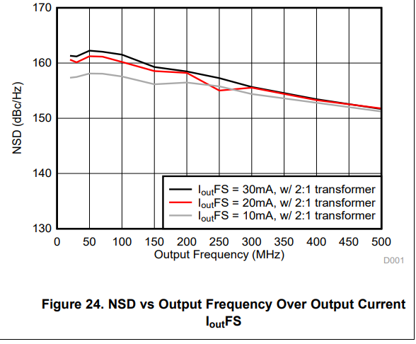

Can you please help with how to calculate the NSD in dBm/Hz of the DAC38J8x ?
The datasheet NSD is defined in dBFS/Hz and it is not clear what is the full scale power in dBm.
On one hand it is defined as 20mA on our tables but on figure 8 it implies it can reach 30mA.
