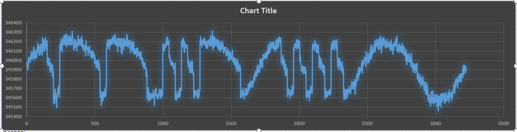

Hi
We are using ADS1292R for one channel ECG and one channel Respiration.  We got ECG signal on channel 2 but not too sure about the respiration data we got on channel 1.
Following are the register configuration:

The raw code data we get from the ADS is attached
/cfs-file/__key/communityserver-discussions-components-files/73/Code_5F00_value.txt

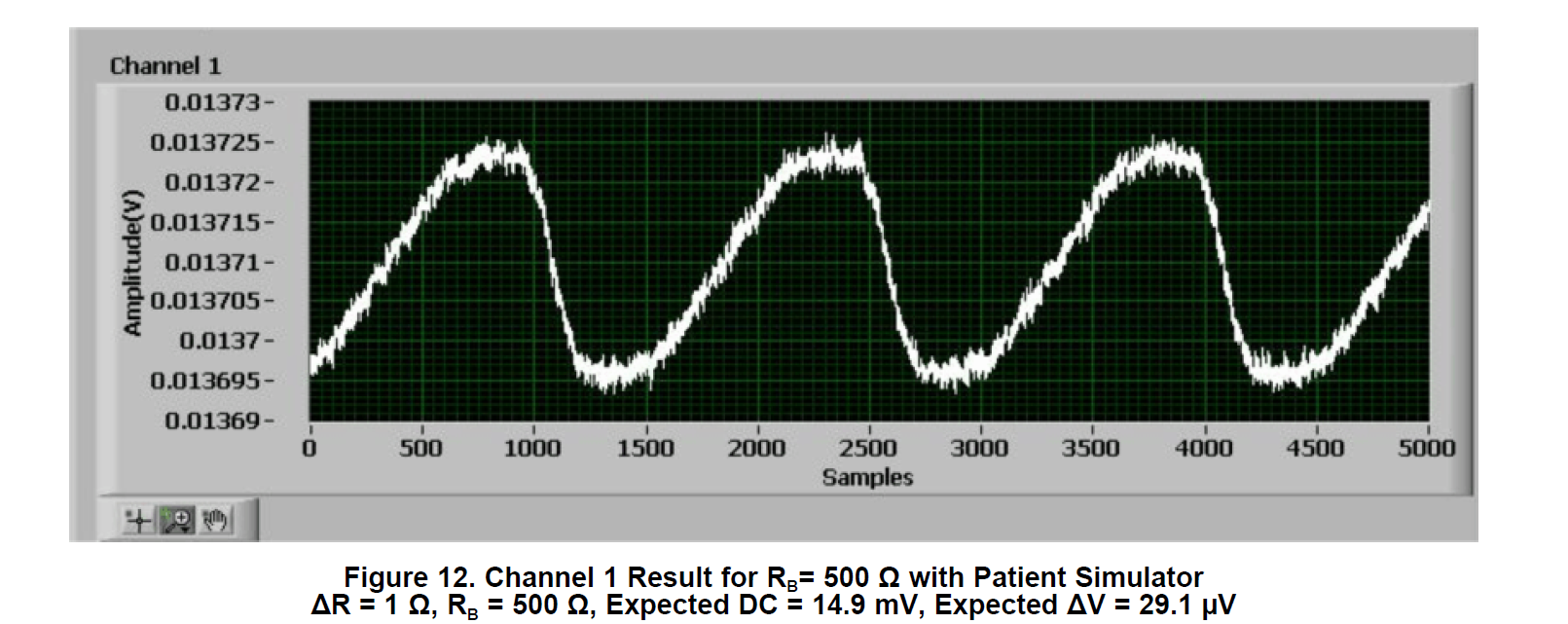

BPM is set to 20, delta R = 1 ohm, Rb = 500 ohm
Respiration graph plotted in excel is shown above. We have used normal ECG leads and used common RA and common LA and RL (three leads) for ECG and Respiration data.
We also tried the ADS1298R evaluation board and in that we are getting the respiration data properly with the patient simulator with same setting.
The data what We are getting is around ‭358680‬  (0x057918) this much and the respiration data in volts should we 15 mV according to application note (Image from application note is added).
- So how this conversion is performed.
- What could be the issue with respiration data we are getting.
