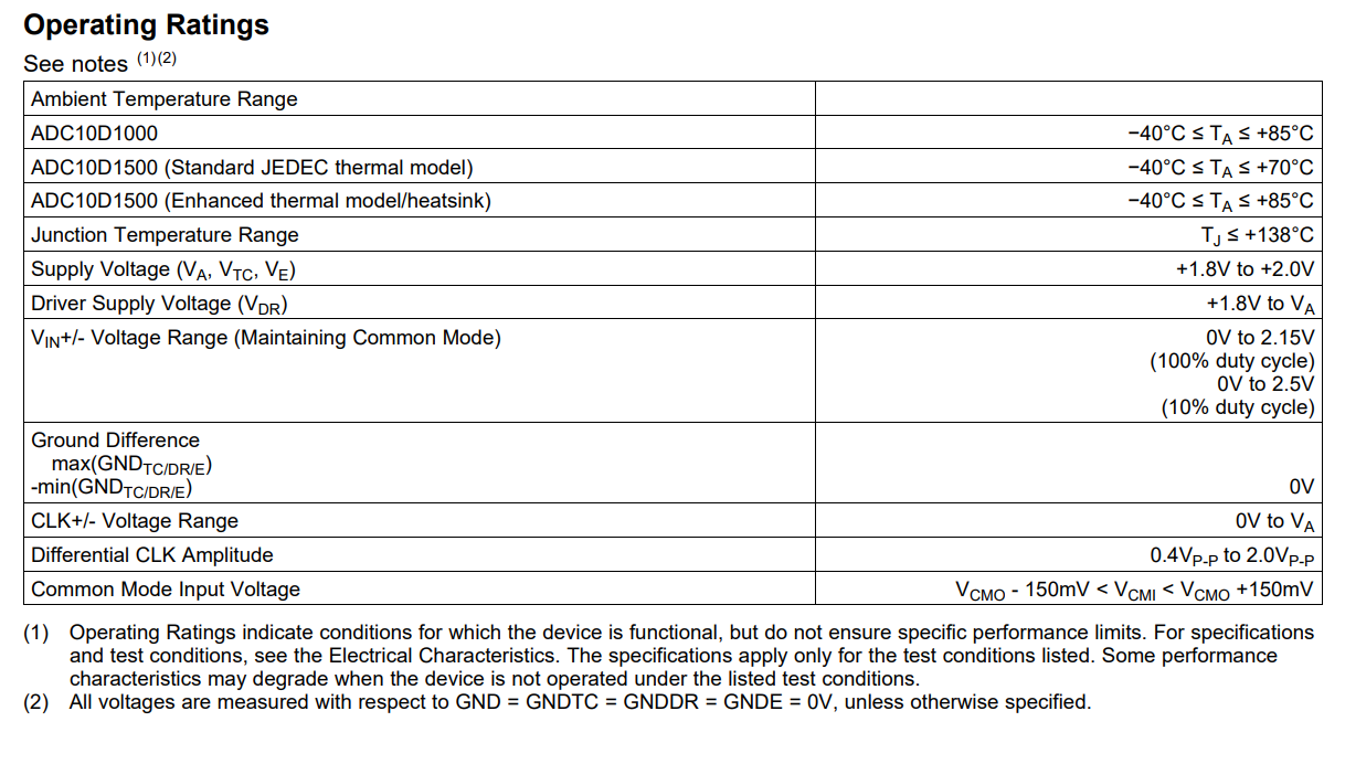

Dear Support team,
Please provide the below thermal data for ADC10D1500CIUT/NOPB
ӨJA (°C/W) =?
ӨJC (°C/W) =?
ӨJB (°C/W) =?
TJ = ?
Thanks & regards,
Divya
Hi Divya,
Is the thermal information in the datasheet not sufficient?
https://www.ti.com/lit/ds/symlink/adc10d1500.pdf
See attached.
Thx,
Rob
