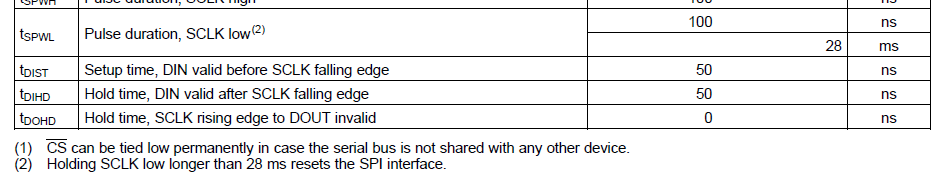

MCU SPI has to get the 16bit SPI data on Low-to-High SCLK edge on ADC124S021. But Customer wants the data as 8bit format. So MCU outputs the long low width on SCLK during between upper 8bit transfer and lower 8bit transfer, when CE is low. Can ADC device accept this sequence? Please let me know.
If you have any spec of period of SCLK_Low, please let me know.
PS. ADS1018 datasheet can find the SCLK_Low MAX specification.
