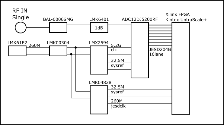

    I think my circuit is similar to EVM.
    I attach a simple block diagram.

    If not windowing, are the clock and analog input frequencies locked with a reference?
    That might be the case. Also what happens if you change the sampling rate of the ADC? Same problem?
    If you have a schematic you can pass of the board that might be helpful as well. I can check the analog input setup with the amplifier/LMH6401.
    Rob

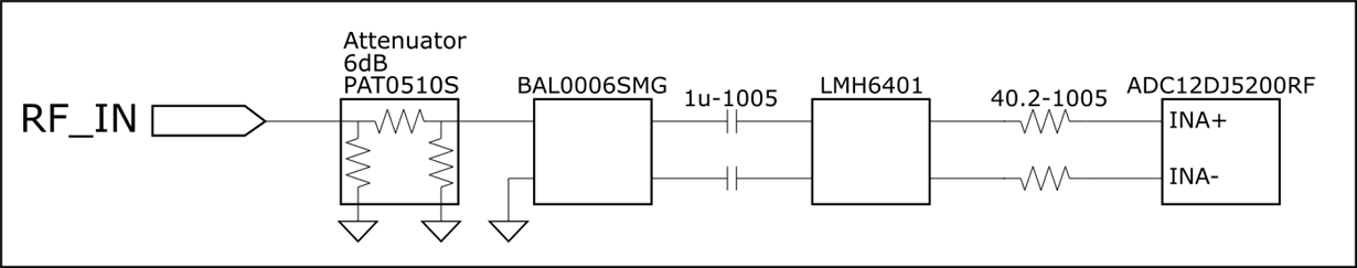

    The circuit from the SMA connector to the input of the ADC is shown below.
    Because the original circuit diagram spans multiple pages and is difficult to refer to, I have extracted only the analog input.

    In the meantime, I would put some AC coupling caps between the output of the LMH6401 amplifier to the inputs of the ADC.
    This will help decouple the common mode voltage of the two devices.
    Let me know what you find using a different sampling rate.
