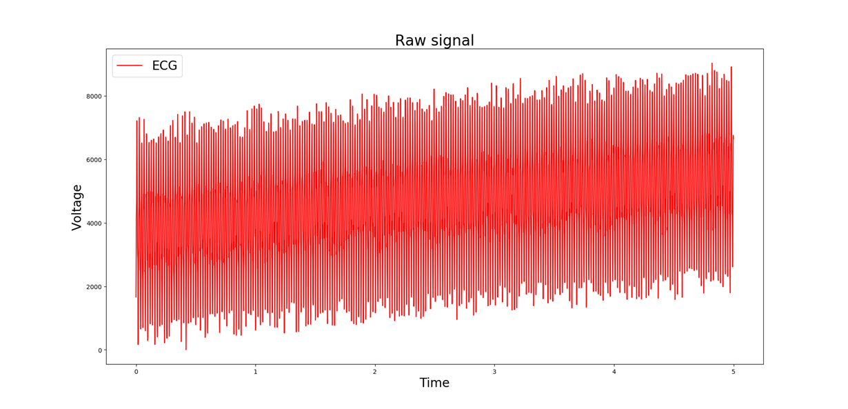

I have been working on an ADS1293 custom board.
I am using only one channel of ADS1293.
But i am unable to get any ECG output.
The output that i get looks something like this...
Can someone help me out?

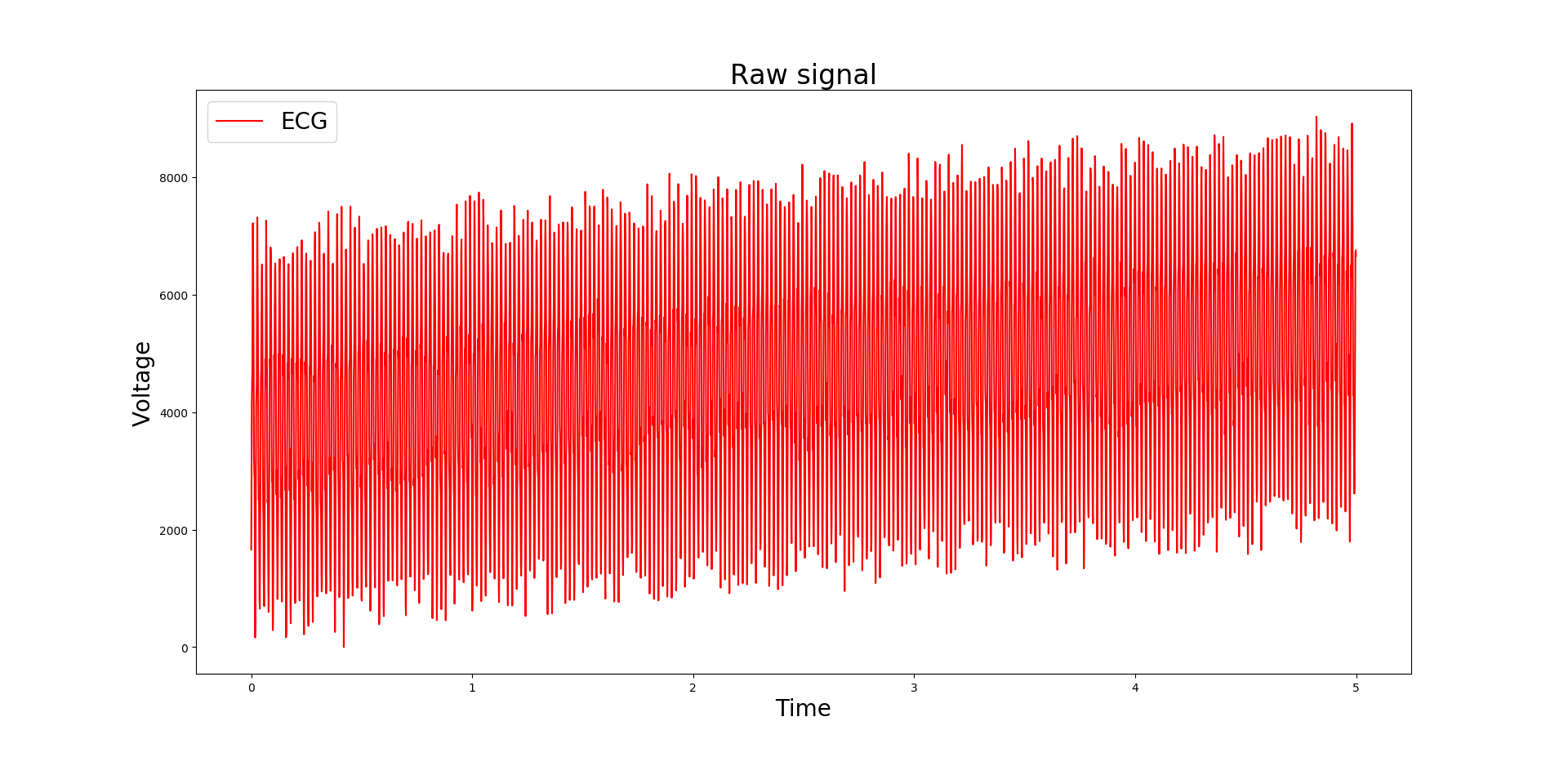

Hi Mohammad,
It looks like there is a significant amount of noise in the measurement. More than likely this is 50/60Hz noise that can be canceled out by using the RLD function of the device. There are many posts on the forum and BIOFAQ page on how to implement this.
