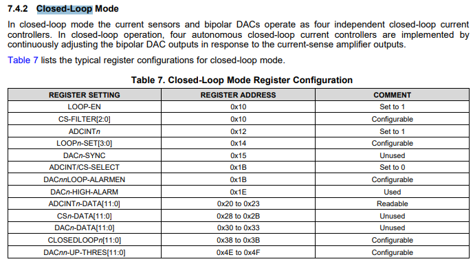

Hi Michael,
Table 7 gives a good summary of the required register configurations for entering closed-loop mode.
Basic order would be this:
1. Power on the different blocks in the device: Writ Power Mode Register (address 0x02)
2. Set the CLOSEDLOOPn target code (Register 0x38 to 0x3B)
3. Set the ramp thresholds (Address 0x4E to 4F), alarms (0x1E), alarm configurations (0x1B)
4. Enable the closed-loop channels (0x14)
5. Set the CS-Filter values and enable closed-loop operations (0x10)
Paul

Hi Michael,
First, we need to check if your shunt value is valid. The AMC7834 current shunt monitor has a full-scale range of 200mV. As a 12-bit ADC is used, we can calculate the LSB size as 200mV/4096 = 48.8µV.
Using a 70mΩ shunt with 125mA would give a differential voltage of 8.75µV. This is well below 1 LSB, so a larger shunt would be needed to optimize the ADC input range. Lets target a nominal input voltage of 100mV deferentially when the current is 125mA. For this example, lets use 800mΩ as your shunt resistor.
Here are the sets.
Once your ADC is triggered, you will set the DAC voltage start to slew until there is 100mV across the shunt.
The other options, such as the filter settings, thresholds, and limits are application specific. The steps above the are the minimum for closed-loop operation.
Paul

Can you confirm if the ADC is converting once you closed-loop operation? Does a readback of all the recommended registers show the expected values? Is the device in some kind of fault state? It would be worthwhile to read all of the status registers and alarm registers. In addition, does the DAC slew to the most negative value or the most positive value?
Paul,
1. DAC - doesn't move at all in any direction
2. ADC - not converting while in closed loop - but in the GUI of ADC mentioned that ADC in auto-conversion. the auto-read not working.
3. no alarms and reading registers is correct with expected values.
Michael

Hi Michael,
Can you confirm what value you used for step 5?
In addition, I recommend that you enter all of the steps on the register map page (low-level configuration) to ensure that the values are being entered correctly.
I suggest power cycling the device and entering the steps through the register map. Then monitor the DAC output with a meter or scope. My concern is that if you are using the ADC page you could be forcing the device out of the closed-loop mode. Issue a trigger or changing the mux can stop the ADC, which will stop the closed-loop mode.

I found a bug in the procedure I sent you:
Step 6: bit 12 should be 'b0 for the device to be in auto mode. Now triggering the ADC in step 7 should keep the device converting.

Hi Michael,
The procedure I provided was specifically for SENSE1 and DAC1. The closed-loop operation only works for pairs of channels (DAC1+SENSE1, DAC2+SENSE2, etc.)
If you are limited to only using DAC4 and SENSE4, then you can use this procedure:
Let's start by ensuring that you are using a correct pair of channels. It would be useful for you to share your connection diagram as well.
