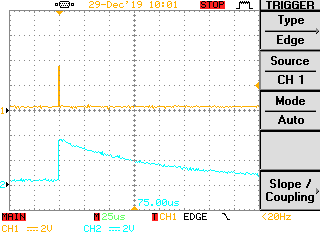

I currently have the same test voltage (+2V) applied to all 6 channels of the ADS8556EVM kit (setup in HW + Parallel data mode).  This helps to insure that all of the data bits (DB0 through DB15) stay at the same (or close to the same) value after a conversion read.
After I command  a conversion, I wait for the BUSY interrupt.  Then I read all 6 channels by:
1. Driving the !CS pin low
2. Toggling the !RD pin low, then high, 6 times (one per each channel read).
3. Driving the !CS pin back high
I took this screenshot (yellow trace shows the BUSY interrupt pulse being generated, Blue trace is directly on pin 64 of the ADS8556, which is DB15, the MSB output):
My test voltage means that the blue trace (MSB bit) should be HIGH, but it is obviously "sagging".  I checked several of the digital output bits, and they all look like this exponentially decaying trace.
My question:  why is the trace sagging?  Shouldn't it remain high?  This is causing my micro to read erratic output values.

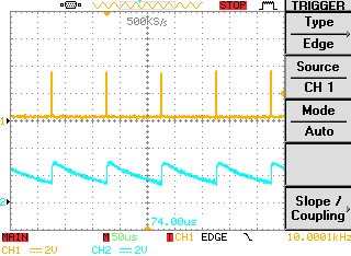

  • Greetings Dale!
    I've included another screenshots for clarification.  The yellow trace is the BUSY pulse on the ADC (J4, pin 19), and the blue trace is the DB15 pin (pin 64 of U4 directly) when I apply a -2V signal to all channels of the ADC (thus, this guarantees that the MSB, DB15, should always be a "1").  If I monitor J5, pin 31, it shows the same issue, so I'm directly monitoring U4 to narrow down the source of the problem.
    These captures were taken with nothing connected to J5 except the two oscilloscope probes (again, trying to narrow down my problem source).

  • Hi Richard,
    I suggest you to use a low capacitance probe, also the probe should have a good ground connection to the EVM board. If possible, disconnect the trace of DB15 signal from U7 for test purpose.
    I did not get the answer from you about my question "What's the code you got in your controller?".
