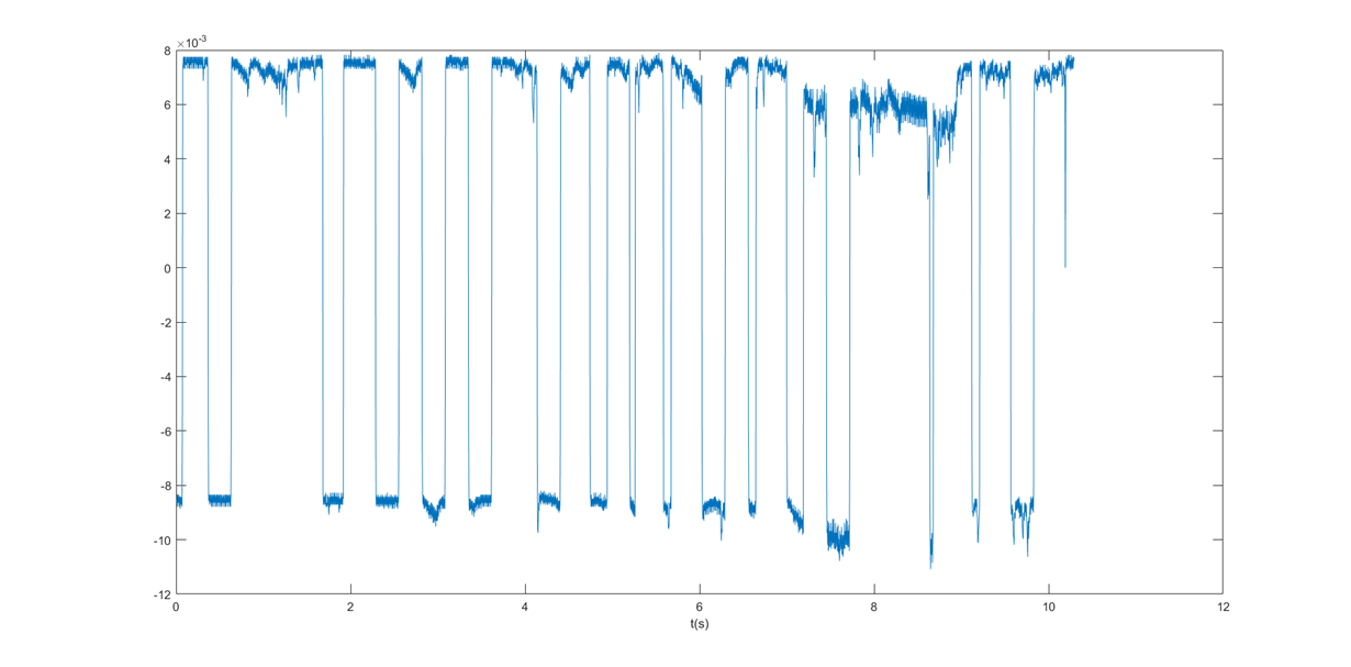

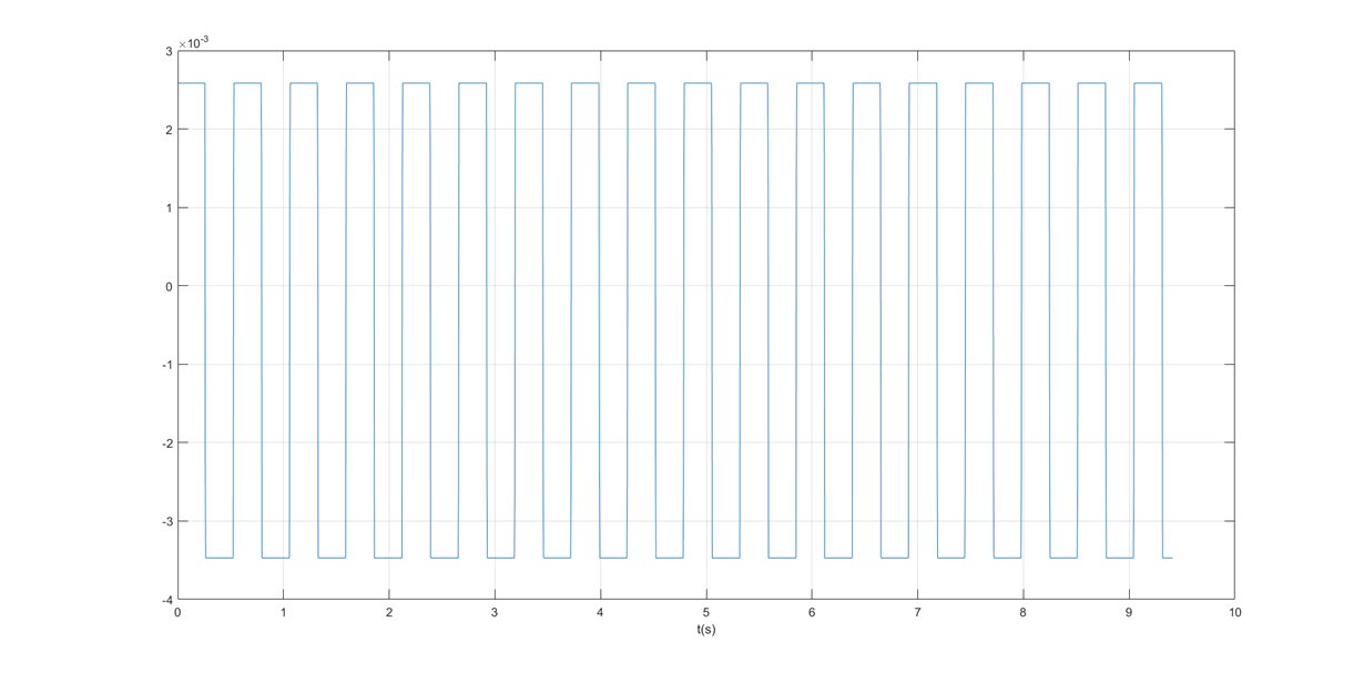

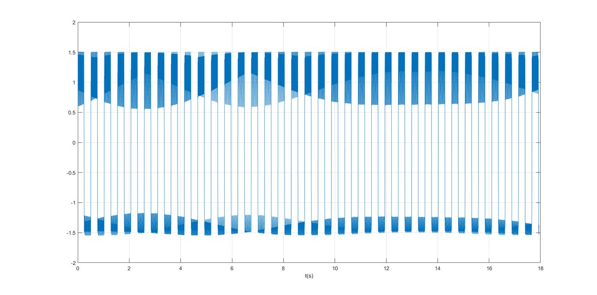

    3. I also tried to test the square signal. I send the the 0x4200A3, 0x440005 and 0x450005 to the chip, and I got this:
    The first is getting from channel 1, and the second is getting from channel 2.
    I just test the square signal only once because when I want to do the test again, I met the situation I discribed in the first question. I cannot start reading data after sending START and RDATAC. I also tried to get the START pin high, but it didn't work neither.

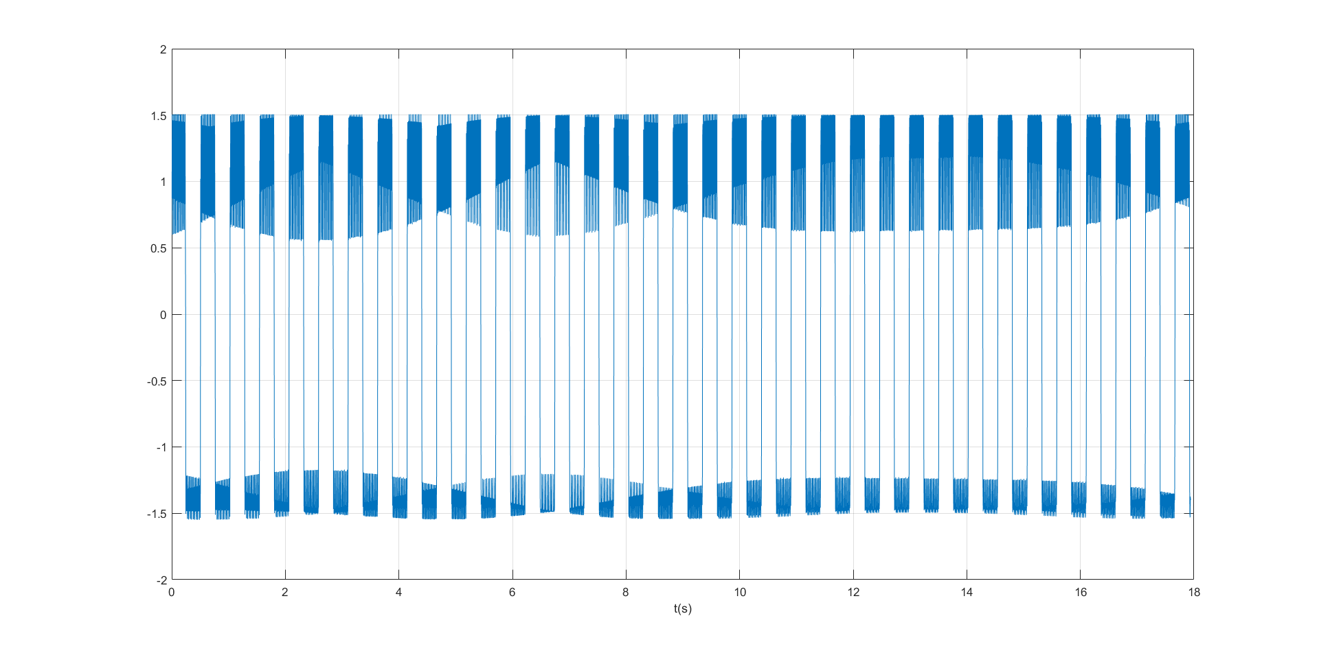

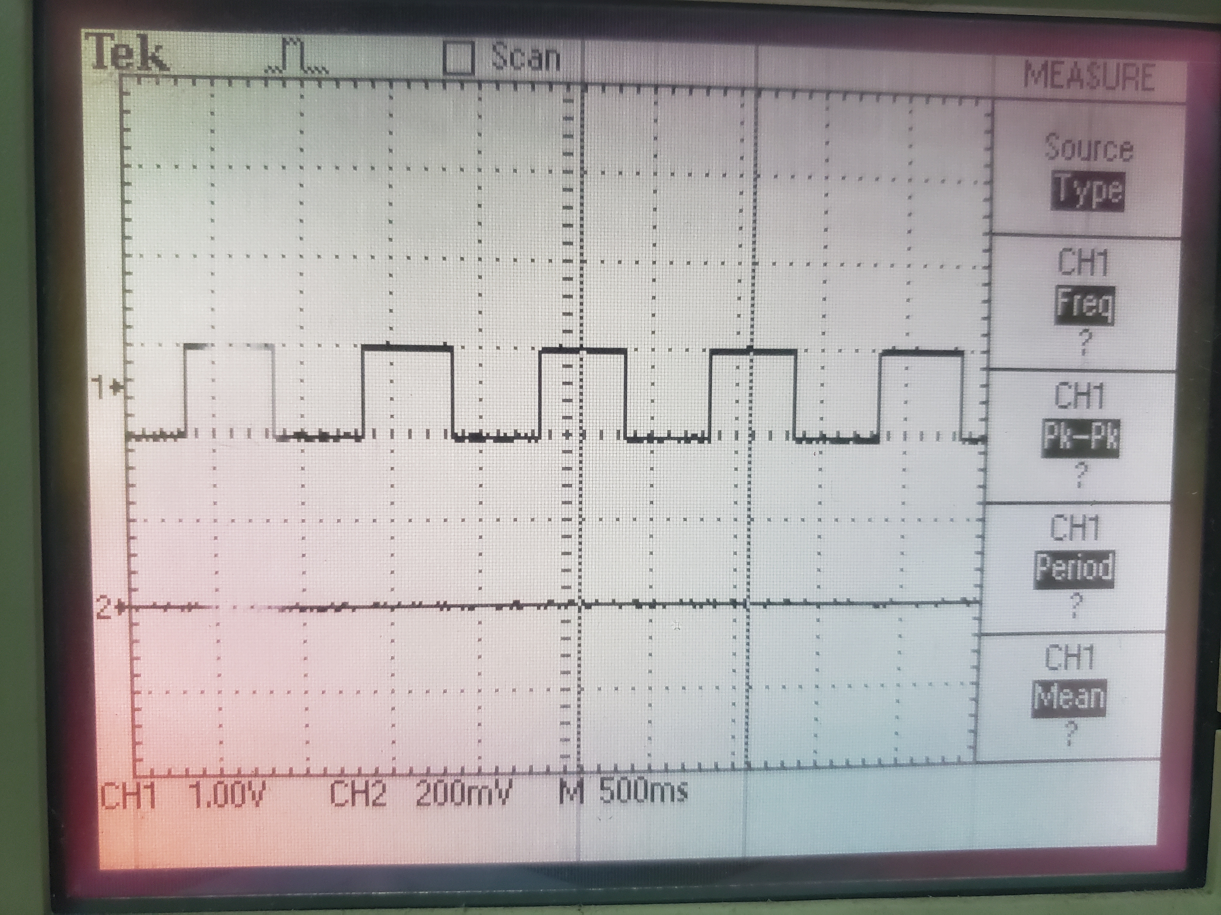

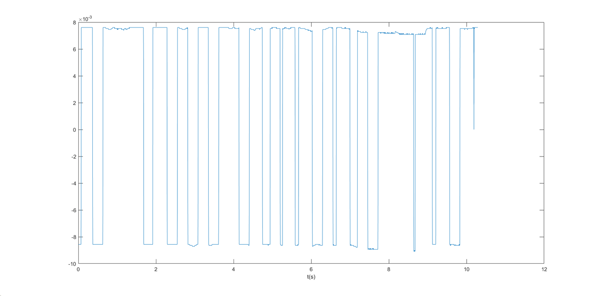

    The second is that I got the wrong frequency when acquiring a square signal of 1Hz generated from a signal generator. Here is the result I got in
    oscilloscope and the ADS1292R:

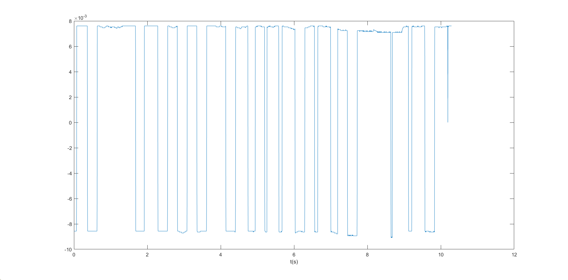

    But when I test it by generating 1Hz square signal from the ADS1292R, I got the right result through both 2 channels:

    Are you using unipolar or bipolar power supplies? In your first post it says 3.3V, which means the bipolar square wave you're applying to the inputs may be outside the common-mode range of the input. Is this oscilloscope picture from the output of the signal generator or the input pins of the device?

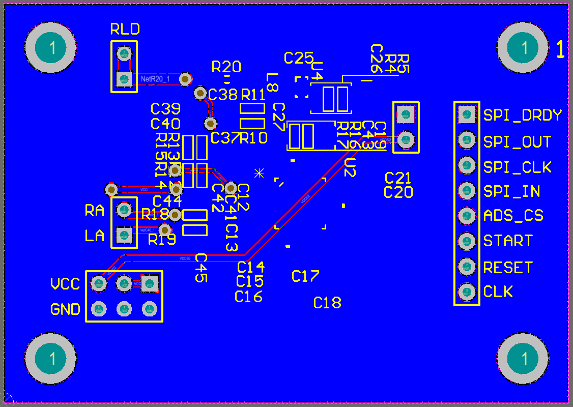

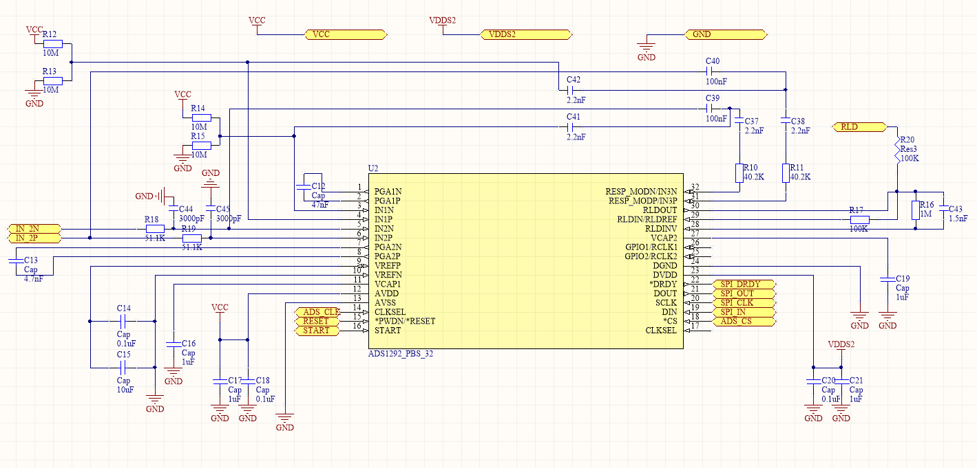

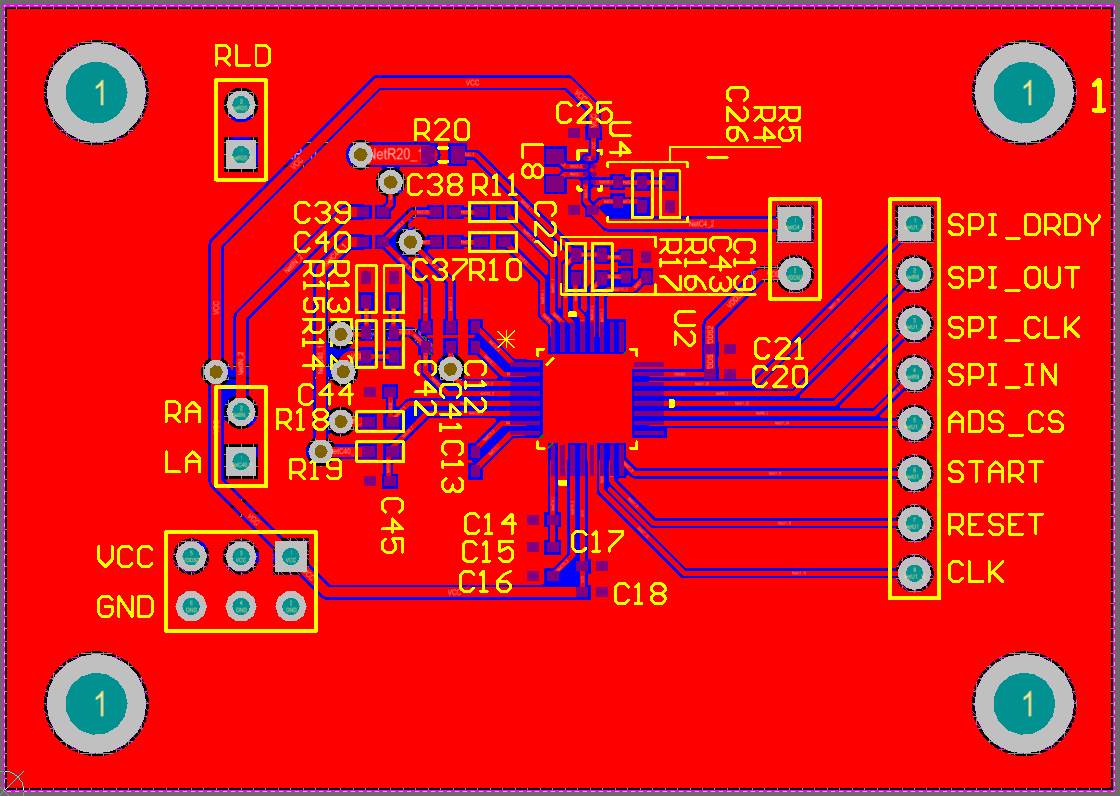

    I didn't let my analog traces cross the digital signal lines, here are my PCB layout and schematic:

    In my last reply, the oscilloscope picture is from the output of the signal generator and the second picture is the result when apply that signal to ADS1292R.

    Schematic looks good. PCB looks ok. There are some analog lines crossing each other, traces go through vias, and it looks like VCC crosses LA. This is not ideal. I would recommend attaching some small wires directly to the input pins of the device and measuring with an oscilloscope to see what exactly is reaching the input of the device. Does it look exactly like the output from the signal generator or is there some extra noise added?
