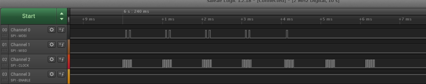

I used the MSP432P401R (MASTER) to initialize the ADS1299 and tried to read the ID, but the identification was 0x00, and I only entered 5 bytes of data in the CODE, but ran out 7 bytes. I do n’t know what happened
This picture is the overall logic analyzer signal diagram, CH0 is MOSI, CH1 is MISO, CH2 is CLOCK, CH3 is DRDY, CS I keep him constant low

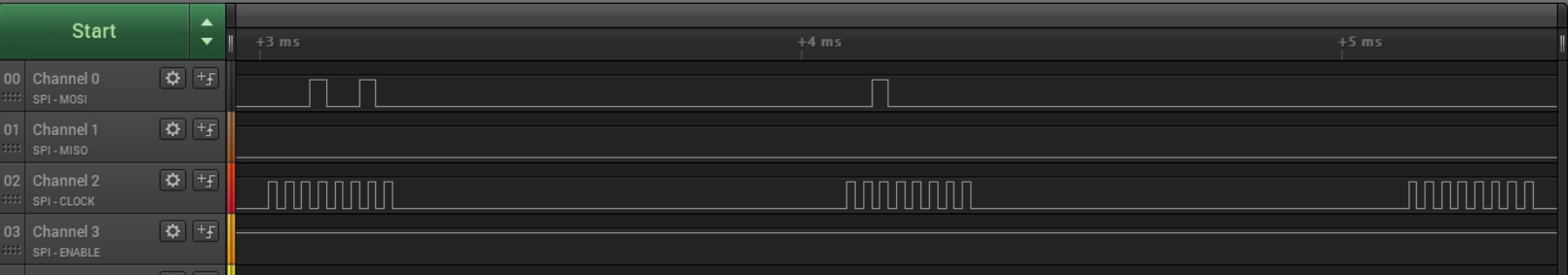

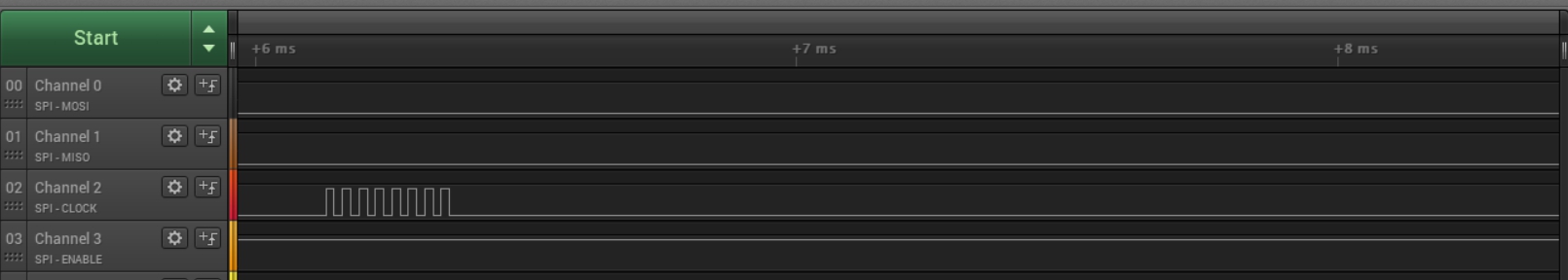

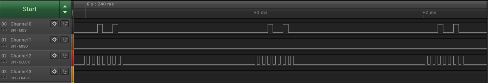

The following three pictures are enlarged views of the first picture, starting from the first byte in order.
