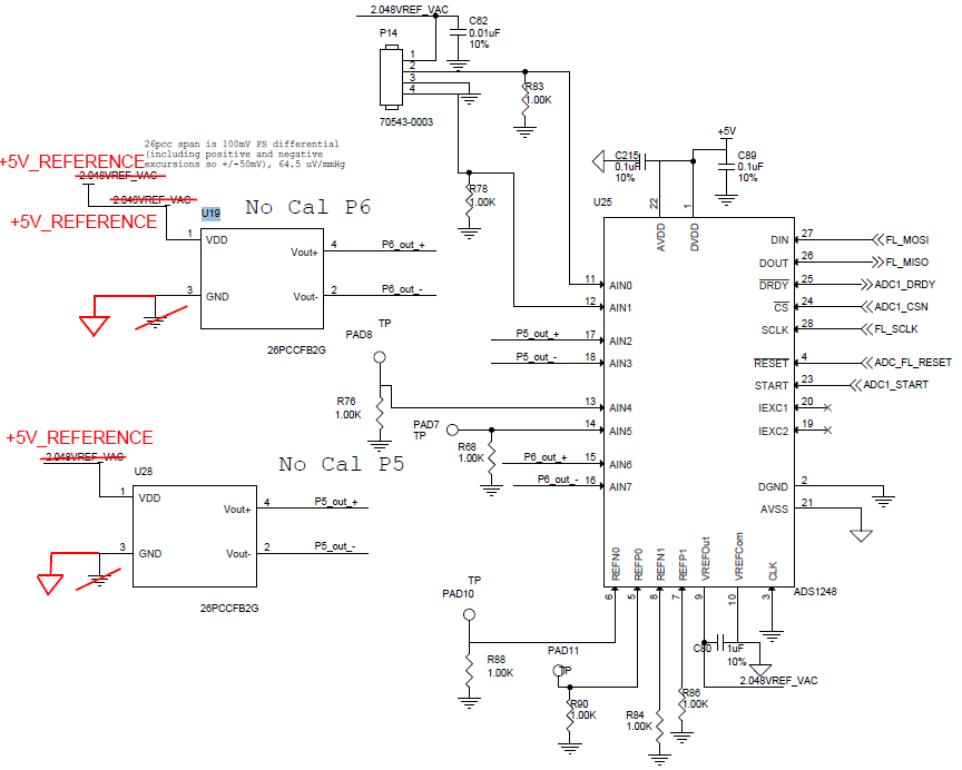

Thank you for your feedback regarding the 5V external reference voltage! In light of your feedback, the re-design approach has changed:
From: Using 5V_REFERENCE, which is a more regulated 5V available on the PCBA design, for both
(1) the reference voltage to the transducer, which is an input to ADS1248
and
(2) an external reference voltage for the ADS1248
To: Using the 5V_REFERENCE only as a reference voltage to the transducers, which are inputs to the ADS1248
The 5V_REFERENCE has its' own ground (triangle ground symbol) separate from the +5V ground (parallel line symbol ground seen in the schematic). Since the input to ADS1248 is referenced to the 5V_REFERENCE ground, which other ADS1248 pins should be referenced to the 5V_REFERENCE ground?
