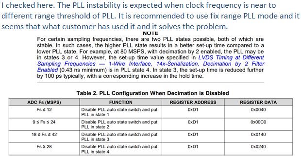

We are using the ADS5294 chips within one of our PCB designs and we have recently discovered that some of the chips (~5% of the PCBs manufactured PCBs exhibit this issue) will not lock PLL state when clocked at 10MHz. The result is corrupted output data since the chip keeps toggling states and never settles, even over a ~10 second period.
In the faulty 5% of our PCB batch (there are 3 ADS5294 devices per PCB) 2 of the chips operate correctly, 1 does not. The faulty chip can be made stable if it is heated up to a temperature of ~ 60 degrees C however as soon as it cools down the PLL state toggling re-commences. Increasing the clock frequency of the chip will also stop the state toggling however the device remains temperature sensitive and if cooled down (using freezer spray) it will start state toggling again. All faulty chips behave in this way, the only difference between chips is at what temperature the state toggling occurs.
Fully functional chips do not exhibit any of this behaviour. We are investigating with the manufacturer if there are installation issues that are damaging the chips.
To fix the issue we have placed the PLL into a fixed state and this results in the chips no longer toggling state and providing uncorrupted data, however we are concerned that we are simply covering up an issue with the chip that may results in total chip failure sooner than expected.

  • Hi Mark,
    From your application, please look at the data sheet mentioned:
    our engineer suggests:
    Thank you!
    Chen

    Thanks for the reply. We have indeed moved to fixed state 1 and this makes all chips work.
    My question however is slightly different to how we fix the issue, it is why are some chips not the same as other chips?
    ~5% of the installed chips will not settle when placed into auto mode, the other 95% will settle quickly, without issue and are not sensitive to .
    Given this information I believe there are 2 possible issues here, the first is that the chips are faulty when delivered (unlikely).
    The 2nd option is that we are over stressing the chips when they are surface mounted, possibly by using an incorrect re-flow profile.
    However to only break the frequency detection part of the chip (and only affect 1 chip out of 3) and nothing else seems unlikely, unless there is a very sensitive component within the frequency detection part and this breaks long before any other part of the chip?

  • Hi Mark,
    For your question, here are the reply from our engineer.
    Thank you, please take a look:
    The PLL supports different range of frequency lock range and it changes its range based on the ADC clock frequency. When auto range mode of PLL is used, the PLL tries to switch the range automatically. In case of input clock frequency is near to the switching threshold then PLL becomes unstable. Also the range detection logic can have some offset across devices. So when customer uses 10MHz clock then for some device (5%) the threshold of PLL range switching is coming very near to 10MHz clock frequency because of which PLL becomes unstable. After writing the fixed auto range bits if device recovers then device is not getting damaged.
    Thank you!
    Chen
  • Chen,
    Many thanks for the reply. To summarise, natural variations in chip manufacture are causing the issue and putting the chips into fixed mode eliminates this issue. These chips that have this offset are not damaged and can be used without any other issues.
    Once again many thanks for taking the time to look into this issue and set my mind at rest.
