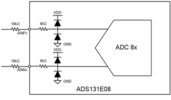

Howard,
Just so that anyone reading this post knows, I've done some measurements with the ADS131E08EVM to see the input over-voltage behavior on the device. Based on the input voltage and current measurements that I've seen, the input (from the EVM) looks like this:
This is why the input pin voltage rises so high. The 6kΩ input resistance inside the device can drop a significant voltage as the input voltage rises.
As I mentioned in my direct email to you, I would limit the input to the ratings in the datasheet. I still think that 7.5V is too high for the input pin, even with the series impedance on the inside of the ADC. It may be useful to add some input protection diodes to VDD on the outside of the device to limit the input voltage.
