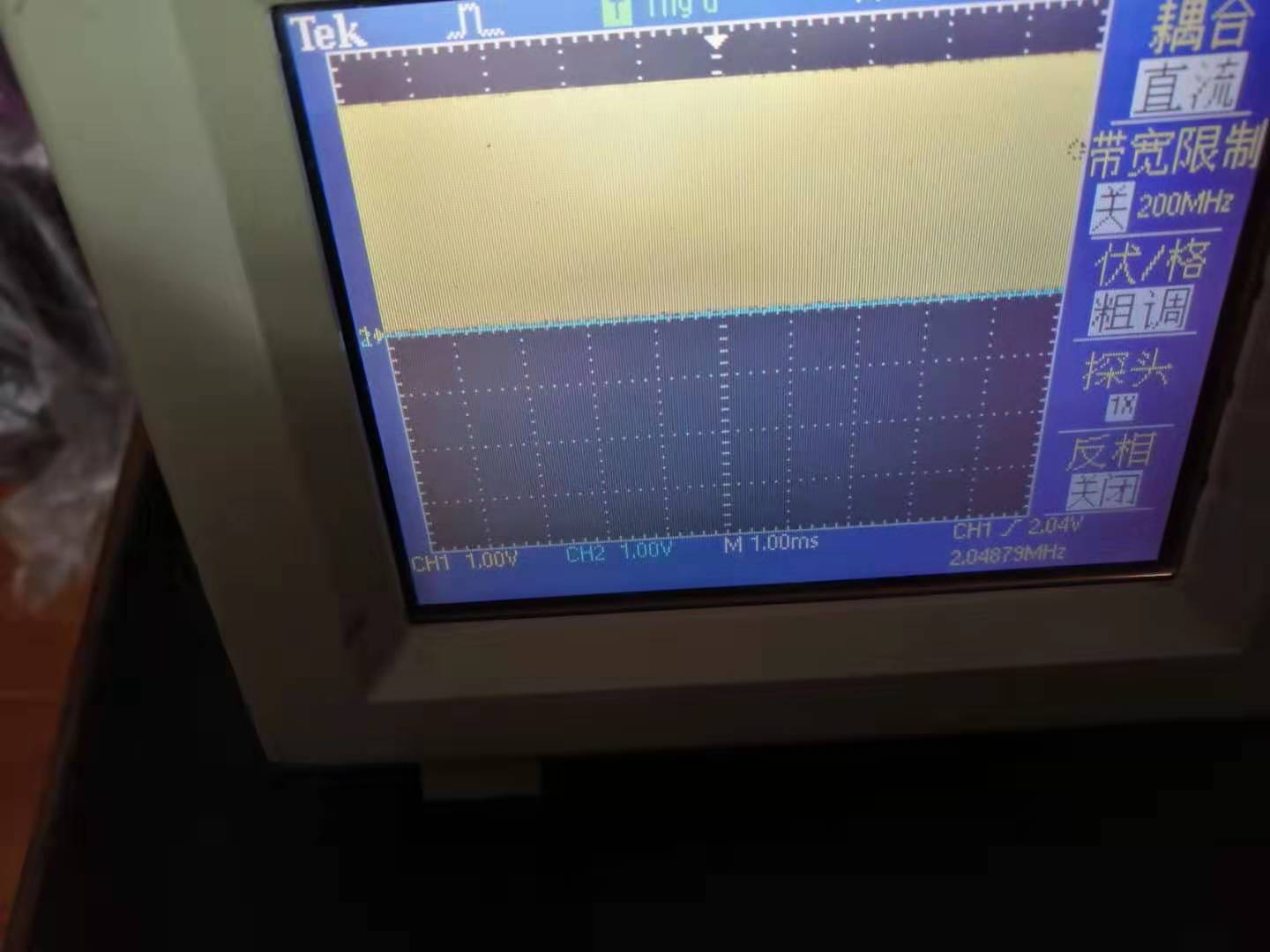

I am using 4 ads131a04 adcs in Synchronous Slave Mode. All devices are configured in Synchronous slave mode as described at the page 73 with following configuration.
M0: Floating, sync slave mode.
M1: Gnd, 24 bit configuration.
M2: Gnd, Hamming code off.

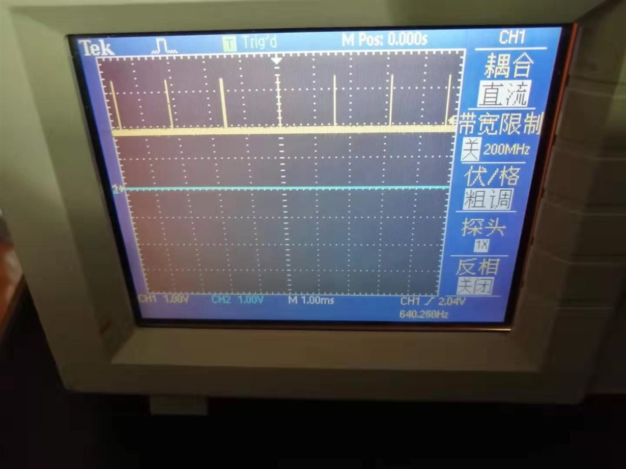

Unfortunately, the curious thing is that the sclk output a clock at 2.048MHz, and /CS output a signal at 640Hz.
I think these signals can be output only when the devices are configured in Synchronous master mode.
when I tie M0 to IOVDD, the same thing happened.
Is the device broken? How can I solve this problem?
Thanks in advance.
/CS:
sclk:
