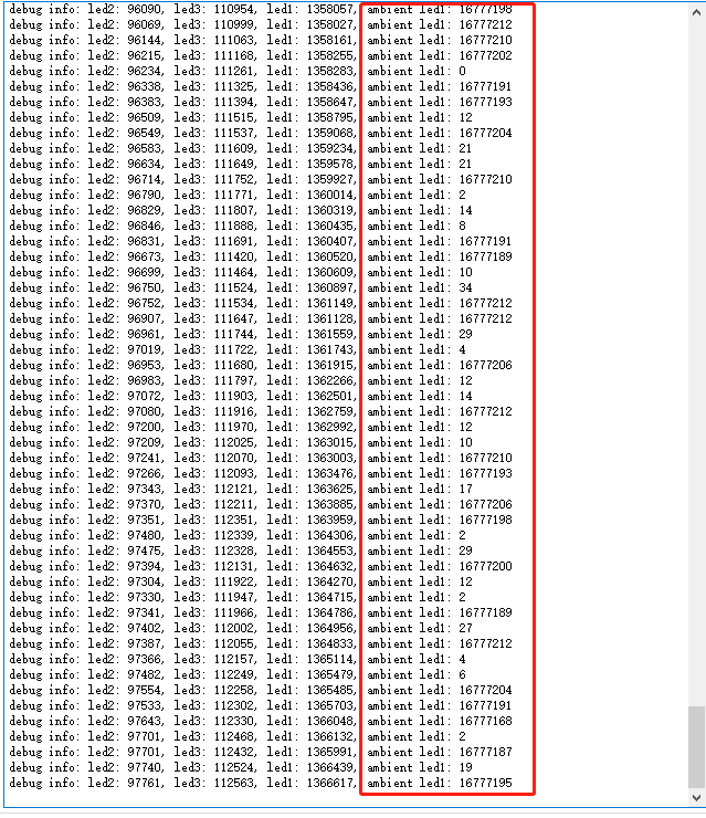

AFE4900 is operated in PPG only mode, but  I can't  sample PPG of phase4 ;
I checked timing, didn't find any problem;
The attached file are configure file and program file;
PLS help;
Best Regards;

    For the PPG only mode, in addition to disabling the PTT mode, you will also need to disable ECG CHOP and RLD.
