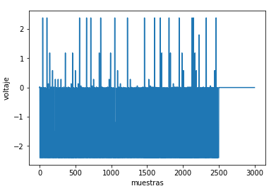

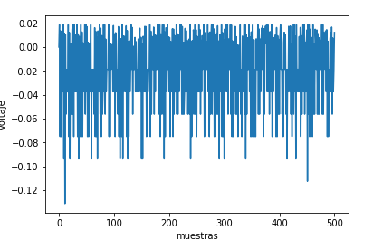

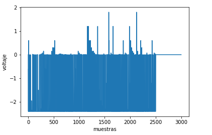

    I've changed the programming, instead of sending the RDATA command i'm using the  RDATAC   following the  figure 93 of the datasheet, and it sends different values not only 0x7fffff nor 0x80000, but i'm not sure if it's working the proper way, since i'm getting as test signal this....
    (similar in each channel)
    (similar in each channel)  this with more samples.
    (similar in each channel) and this when i connect myself.
    i don't really see what i want to see on this. I'm sampling 500 SPS and it doesn't show what it supposed to the square signal on the Test and the heart signal with noise or something, so i don't know.

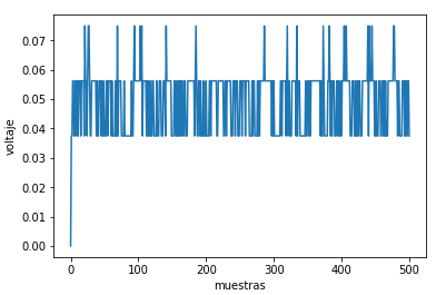

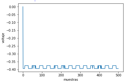

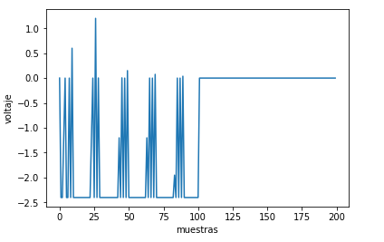

    I've achieved to lift the VREFP voltage so now that pin is 2.4 and the VREF=4.7v.
    When i put the test signals i get this result:
    channel 1
    channel2
    Channel3
    Certainly it has been a progress since i've lifted that voltage. Channel one seems to be failling but i dont now why, it could be damaged?, the second channel ilustrates the square test signal with noise, i guess its working?, and the third one is the best signal of all, this could have solved that. Nontheless, when i connect my self i still don't get the signal that i want for the device.
