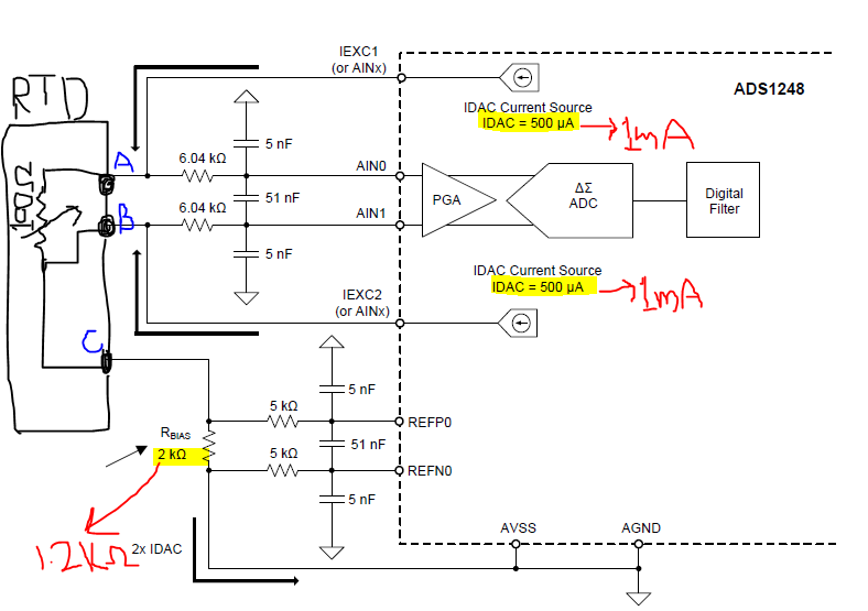

Dear sir,
Please help me to come out of this problem.
Now i am dealing with ADS1248 for reading temperature using  RTD Sensor, i am using below  attached code and ADS1248 driver header file.
My SCHEMATIC Details:-
Schematic having below things:-
AVDD = 5V (Proving input voltage of 5V through 10uF capacitor)
AVSS = GND
DVDD = 3.3V
DGND = GND
CURRNET SOURCES = IEXC1 and IEXC2
ANALOG INPUTS = AIN0 and AIN1
REFERENCE Resistor = 1.2kohm
I changed Rref to 1.2kohm because in ADS1248 Datasheet  Vref should be below mid-SUPPLY of AVDD(Section 10.2.1.2.4).
Below voltages and currents with respective of ground i am getting:-
Before connecting RTD Sensor(three terminals(A,B,C) are open):-
At point 'A' voltage and current = 5.031v and 0.992mAmp
At point 'B' voltage and current = 5.030v and 0.993mAmp
At point 'C' voltage and current = 0v and 0mAmp
Voltage at Rref = 0.0v
After connecting RTD Sensor with 100ohms(means B and C terminals are shorted and Terminal A is open then connected RTD Sensor):-
At point 'A' voltage and current = 2.401v and 1.827mAmp
At point 'B' voltage and current = 2.398v and 1.827mAmp
At point 'C' voltage and current = 2.398v and 1.833mAmp
Voltage at Rref = 2.398v (Vref = AVDD/2==>5/2==>2.5v)
After setting all registers of ADS1248 like below code, then i am reading outputcode like below
output_code = ADS1248_RDATA();
but every time i am getting same value(output_code = 16777215) while changing RTD sensor manually like 100ohm to 150ohm. No change in output.
If change RTD sensor resistor value, it is not effecting at point A, B ,C means voltage not changing.

Schematic:-
So please see my problem give me  suggestion i red ADS1248 Datasheet, Basic RTD sensor using datasheet, i got formulas for converting outputcode into resistor and then resistor to temperature.
1) Internally how ADS1248 convert analog data to digital form?
2) Is it compulsory to calibrate digital data to get correct output code?
Please help me. I am struggling so much since one month.
Thanks in advance,
amarr
  • Hi Amarr,
    The ADS1248 converts analog data into digital for using the delta-sigma modulator. The modulator compares the analog input to the reference voltage, and output a code the is proportional to the analog input compared to the reference.
    Calibration of the digital data may be necessary depending on what type of offset and gain error specifications your design is trying to meet. I would not recommend writing to any of the calibration registers for now.
    You are currently receiving a full-scale output reading, which means that the analog input voltage multiplied by the gain and calibration register is greater than the reference voltage.
  • Thank you Smith, Means I am getting correct values based on my above source code. Right? But why raw value is not charging according to the rtd sensor resistance value. Is there any changes required to the my schematic? Please suggest me Thank you, Amarr
  • Hi smith,
    In ADS1248,
    1) how it will take reference voltage(means if I configure ADS1248 registers for internal voltage reference enabled and internally connected to REFN0 and REFP0. Then still i should i give external voltage to REFN0
        and REFP0 pins or voltage is supplied from ADS1248 IC? If voltage supplied from ADS1248, How much voltage will shown at REFNP0?
    2) If  AVDD = 5V then what is the Rref value? or if AVDD = 3.3V then what is the Rref value? for Three-Wire RTD Measurement, Low-Side Reference design?
    3) Can you please share me register settings for reading temperature using RTD Sensor by connecting it to ADS1248?
    4) If i change RTD Sensor resistor value, will it reflects to Analog pins(AINp, AINn) voltage?can we observe it using multi meter?
    5) How Vref is used to calculate ADC data in ADS1248?
    6)How ADS1248 will take analog data(voltage), will take difference voltage between them?
    7) Can you please share flow of one ADC to Digital conversion result in ADS1248? means how it will excute it with DR = 20, Gain = 4, default values digital filter settings?
    Thank you,
    AMARR
  • Hi Amarr,
    I think this training series will help answer some of your questions: https://training.ti.com/introduction-designing-delta-sigma-adcs-training-series
    Please consult the ADS1248 datasheet characteristics table for typical internal reference voltage magnitude.
