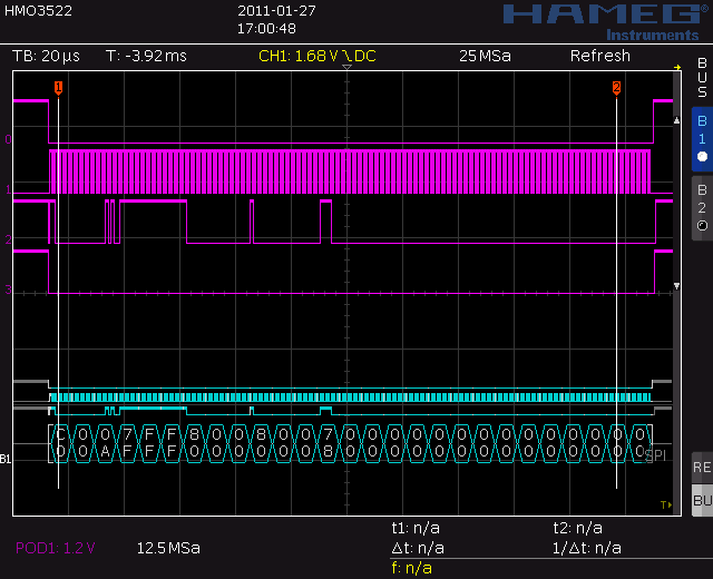

  • Hi Kai and Tom,
    it seem to be I'm just running in the same problem. I'm not able to read the correct ID from the ADS1298. I can write and read all registers correct except the channel register 4 to 8, are always 0x00. The ID is always 0x80. Take a lock into "Register Read.png", the first two bytes (0x00,0x00) are the respond from the read register order 0x20, 0x00.
    At first I  thought I have a wrong chip in the package and changed the device on my board. But the same result. I believe the chip is a 1294.
    The next problem is, in continue read mode I get always the same data. Please take a lock into the scope picture (ContinueDataRead.png). No noise on the channels, unbelievable! And the data for channel 4 to 8 are always 0x00. All LOFF registers are switched to disable. I have no idea what's going wrong.  Please give me a hint.
    thanks Olli
  • and here is the other picture.
    Olli

  • Hi Kai,
    my problem with the wrong ID and the missing channels could i solve. 3 off 6 analog power pins were unconnected because off a broken pcb track. Probably the power supply for the higher channels.  So, i get the right ID (0x92) and data from all channels.
    The ADS1298 is fine working now and i'm happy.
