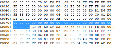

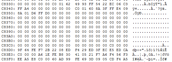

Hi community,
i am using a RPi3 to get the data from the ADS131E08 EVM, i have found that after a while i get corrupted data.
-using 64 kHz sampling
- SPI clock 25 MHz
- the problem interval is random and also when unplugging an input
While reading the data from the A2D I get an error as shown in the following pictures
after the all 00 lines the data are corrupted.
