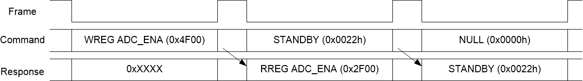

Does DRDY pulse output operation stop in Standby mode?
My user wants to minimize power consumption when MCU is in sleep mode.
Can I determine if the device is in STANDBY mode?.
Is it possible to set by ADC_ENA Register to set to Standby mode?
Are the following steps correct?
(1). ADC OFF : 1Frame transmission (0x4F000000)
(2). NULL : 1Frame transmission (0x00000000)
(3) .ACK confirmation: (Wait 0x2F000000)
※ Repeat (2) ~ (3) until ACK confirmation
(4). STANDBY : 1Frame transmission (0x00220000)
(5). NULL : 1Frame transmission (0x00000000)
(6) .ACK confirmation: (Wait 0x00220000)
※ Repeat (5) ~ (6) until ACK confirmation
