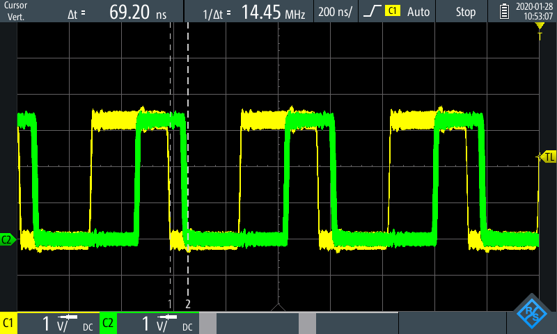

  • Hi Costin,

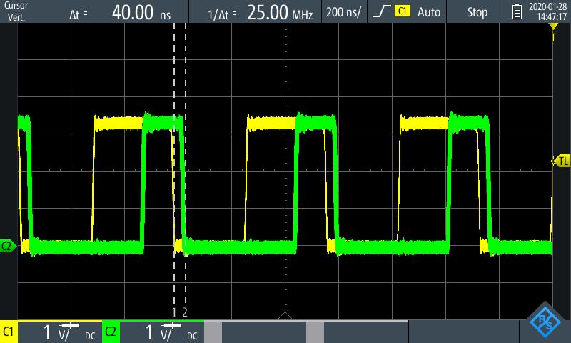

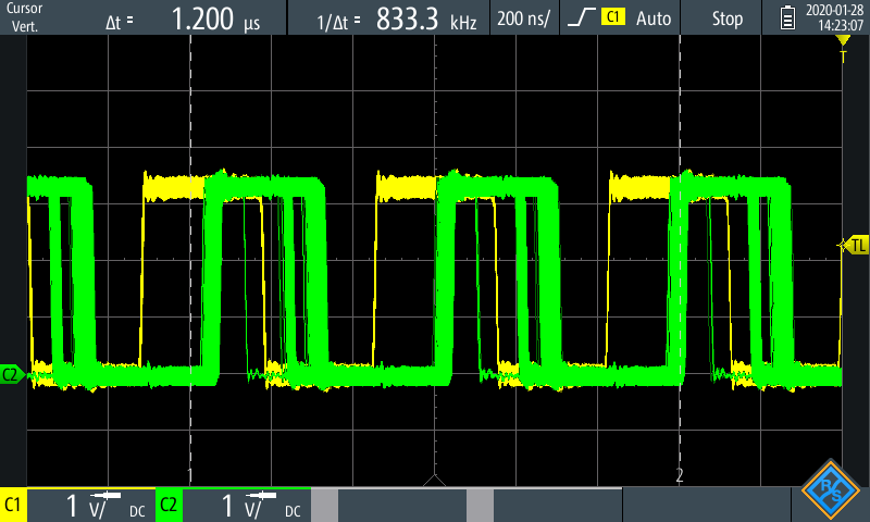

    I tested a few things.
    I have shown the input and output clock with an infinitely long afterglow time on the oscilloscope and good circuit board
     compared with bad circuit board. Unfortunately I can not find anything about propagation delay in the data sheet.
    Here are a few pictures at room temperature and cooled with cold spray.
    With cooled lm98714 there were phase jumps in the output frequency.
    Bad PCB with cooling (Input CLK yellow output CLK green)
    Bad PCB with room temperature (Input CLK yellow output CLK green)
    Good PCB with cooling (Input CLK yellow output CLK green)
    Good PCB with room temperature (Input CLK yellow output CLK green)
    Furthermore I tried different configurations of the lm98714. I tried to change coarse pixel phase alignment, I changed the polarity and the duty cycle of the output clock.
    Unfortunately, always with the same result as in the bad pictures.
    I also disconnected the CIS module. This did not result in any change either.
    Next I'm going to put the chip down and solder a new one onto it. If the error persists, I have suspected the board as the cause of the error. We have already built about 200 boards, but so far we have seven boards with this defect that we know of.
