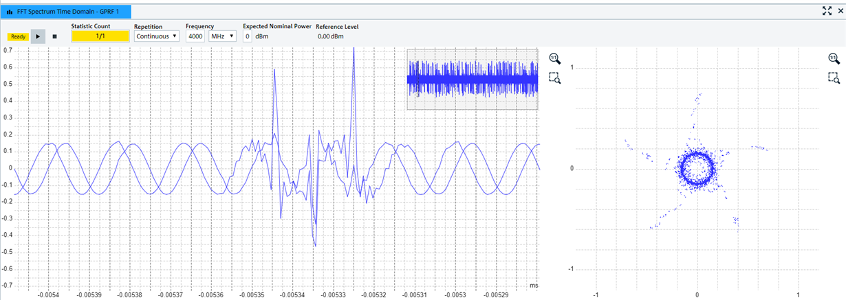

we use the ADC12DJ2700 on one of our own boards.
In some cases we have a special error with the ADC:
The noise floor in the spectrum is very high and seems to have a periodical ripple signal on it.
In the time domain we get a very ugly disturbed signal (testet with a sine signal an both ADC channels).
With the same setting and a new initialisation of the ADC we reach also an error free state:
Months ago I saw this behavior On the ADC12DJ2700 evalboard, too. But I assumed that this comes frome the early chip version. And after reinitialisation the error was gone.
Do you have any experience with this bahavior?
Is there any problem with the JESD interface? Which steps do you suggest to improve the JESD connection?
Very interesting: sometimes in the error case the OVL-output pins from the ADC shows an overload.
We configure the ADC in JMODE9 MODE.
It would be very great if can give some hints.

  • Hi Paul,
    Can you please provide the register writes you perform to program the ADC? Also can you try running the ADC at lower sampling frequency and can you also try the ramp test mode see if you observe any error?
    Neeraj
  • Hi Paul,
    If the ADC is left completely alone and just reset the FPGA side of the JESD204B link, does the error condition continue or does it get fixed?
    If this only resolves the problem by re-initializing the ADC what steps (clock startup, ADC register writes) are they using in the initial startup and what steps (register writes, any changes to clocking, etc.) in the re-initialization?
    Please confirm that the over-range signal that is being monitored is on the ORA0, ORA1, ORB0, ORB1 pins and not the OVR_Tx signals in the serial data stream.
    If seeing the ORxy pins toggling, then we would expect there is a problem with the initial ADC startup sequence that is resulting in unstable behavior.
    Rob

  • Hi Paul,
    Are you still seeing the same issue?
    Neeraj
  • Hi Neeraj,
    yes, we still see the same issue...
    Debugging the FPGA brings following error message: ‘Unexpected K-character(s) received’ (output from FPGA Link Error Status Register).
    Do you have seen such errors (see screenshots above) at the evalboard, too?
    Paul
