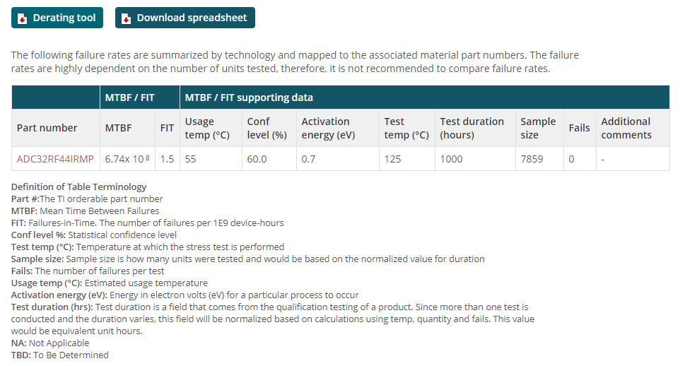

  1. Looking at the register map, it says that register 017H inverts the individual lanes. If I invert lane 1, does it invert lane 1 on both DA1 and DB1? Or is there a way to invert each one indivudually?
  2. In the datasheet, the ThetaJC on the ADC32RF44 is a little higher than some of our other ADCs, and some of our simulations are having trouble keeping the device under the recommended 105C. The datasheet says that 125C is the max, but performance/reliability starts to degrade above 105C. Do we have an validation data or guidance on the reliability over temperature?
Let me know if you would like to take our discussion offline.
