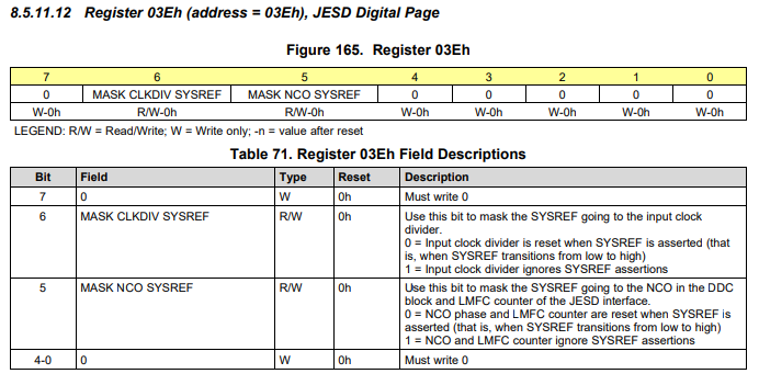

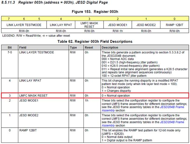

Could you tell me the function of LMFC MASK RESET bit?
What is occured if we set LMFC MASK RESET=1?
The background of the question is my customer wants using SYSREF to reset NCO but not to reset LMFC Counter.
Is it possible?
