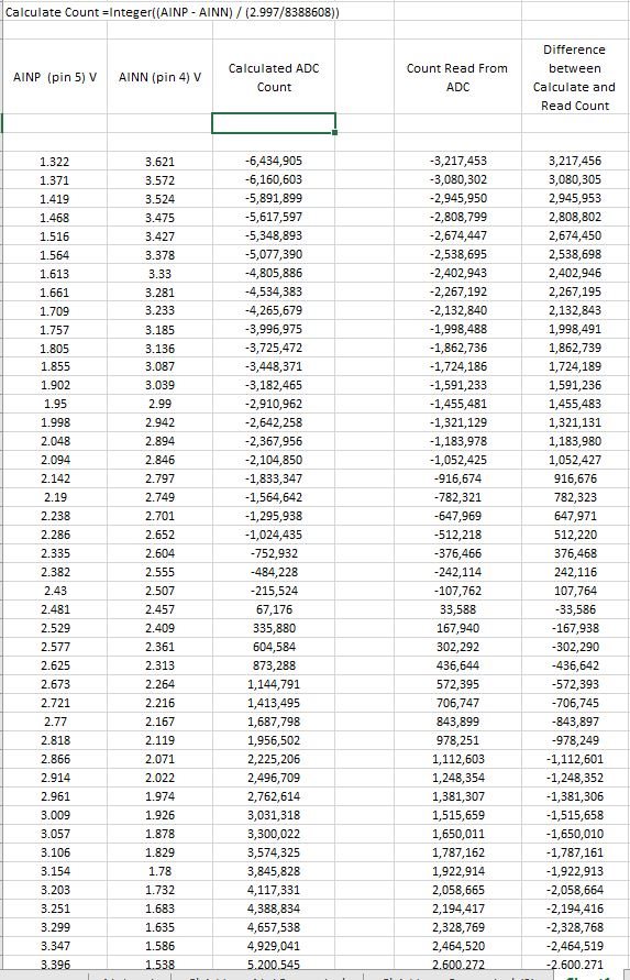

Hi:
The differences between the calculated ADC counts and the read (actual) ADC counts are increasing as the differences between AINP and AINN input are increasing as shown below. What could cause this to happen ?  Thanks.
  • Sorry I copied and paste incorrectly.  Pleae ignore data in my last post. The following is corrected data.

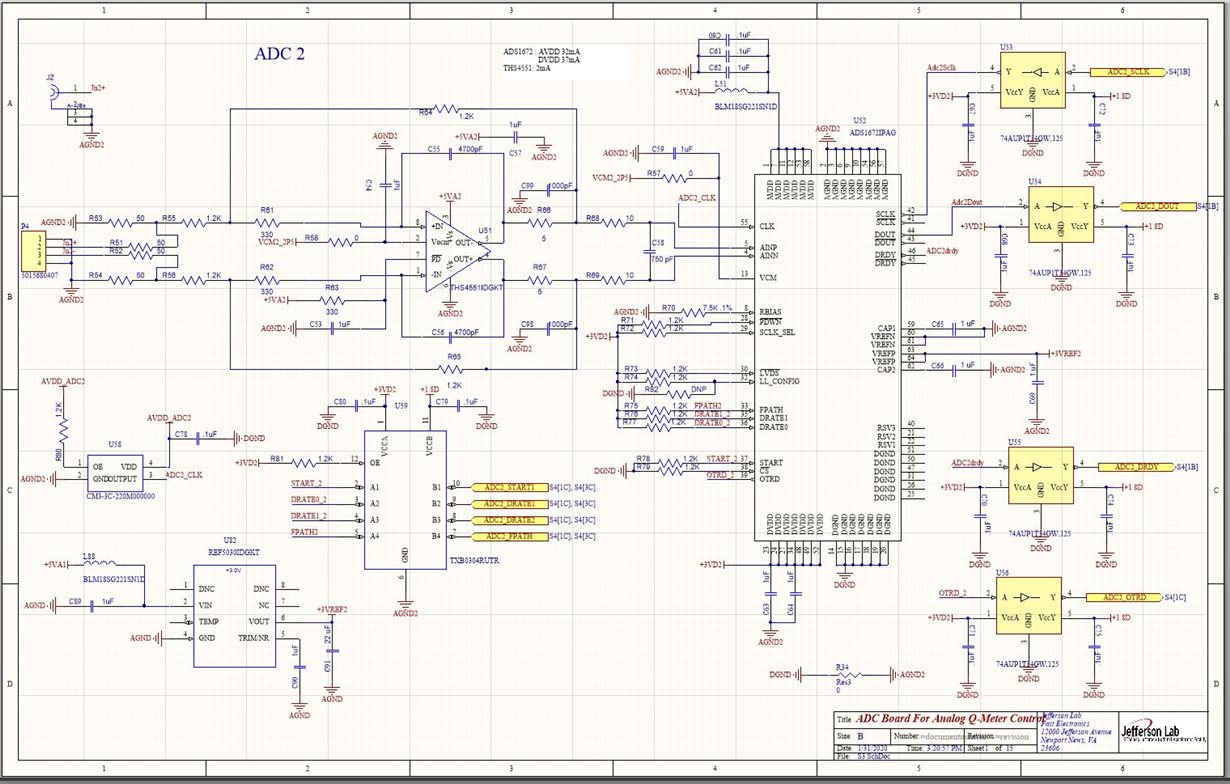

    The data appears to suggest a gain error.  This could be caused by the Reference drooping or the input filter is not fully settled.
    Please send a schematic showing the ADC, input amplifier, Reference, and the supply voltages used and I can take a closer look.

  • Hi Keith:
    Thanks for the quick response. Several notes on the schematics:
    1) The issue is there whether the VCM of op-amp is connected or not connected to ADS1672.
    2) The issue is there whether CLK is 8 MHz or 20 MHz. At first I have 8 MHz so I change to 20 MHz.
    Hai
  • Hello Hai,
    The input amplifier configuration looks O.K.  However, I suspect the reference circuit is the problem.  The REF5030 output buffer does not have enough bandwidth to directly drive the input of the ADS1672.  As a result, the voltage will droop, which will appear as a gain error.
    You mentioned the error is there whether CLK is 8MHz or 20MHz, but if this is the cause, there should be less gain error at 8MHz verses 20MHz.
    You can use the REF5030 with an additional reference buffer amplifier.  Here is how the evaluation board is configured:
    Another option is to use the REF6030.  This device has similar performance to the REF5030, but includes a high speed buffer, capable of directly driving the reference inputs of most ADC's.  I have not tried this part with the ADS1672, but based upon use with other similar ADC's, it should provide good performance.
    Keith

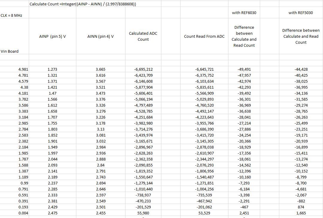

  • Hi Keith:
    Yes, the gain error is slightly less at 8 MHz (@1.322V AINP and 3.621V AINN, the difference is -44,428 @ 8 MHz and  -48,905 @ 20MHz).
    I will wire in the REF6030 and let you know the results.
    Many thanks for your help.
    Hai
  • Hi Keith:
    The gain errors are actually worst with REF6030 as shown in the enclose Table . I have the REF6030 circuit wired per your picture.
    Also with the data I sent to you, I have C99 and C98 connected to  AINP and AINN inputs respectively since I thought the 10 Ohm R68 and R69 might cause the input to droop at higher voltage.
    What should I do next ?
    Hai
  • Hello Hai,
    I just realized your gain error is around 0.8%.  If the above readings are the raw data from the ADC, no adjustments for offset or gain, then I think you are just seeing the expected gain error.
    The ADS1672 has a max gain error of 1%.  The resistor network around the THS4551 will also have error.  Assuming you are using 0.1% resistors, this will add another 0.2% of gain error.  If you are using 1% resistors, then this could add up to 2% gain error.
    Also, looking at your schematic, the ADC VREFN pin is connected to AGND2, the Reference ground is connected to AGND.  If there is any voltage difference between these pins, then this will show up as a reading error.
    Keith
