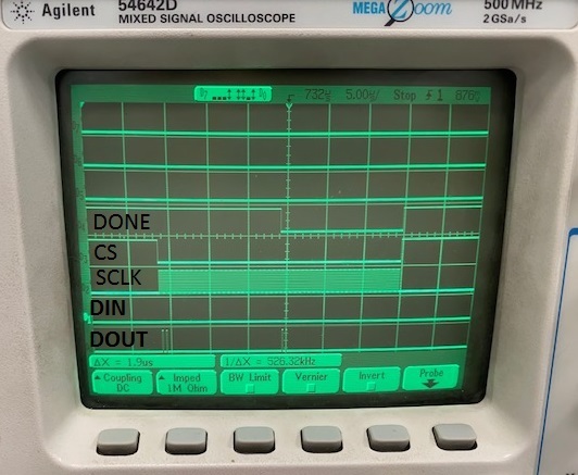

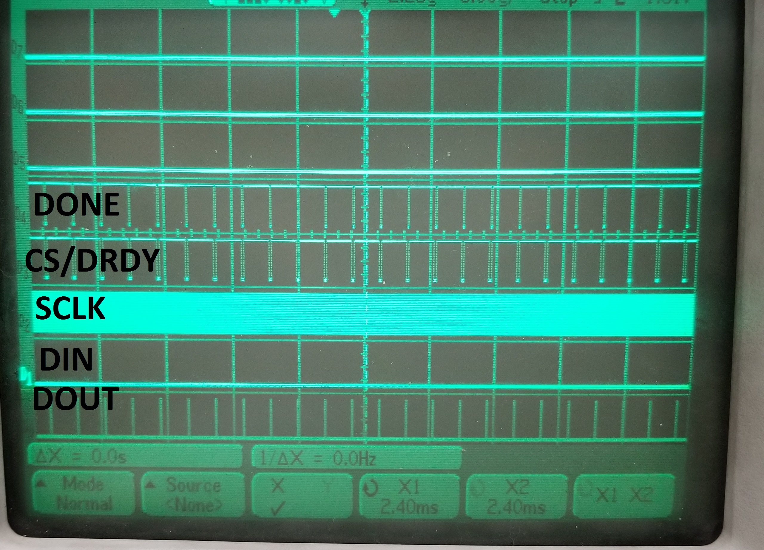

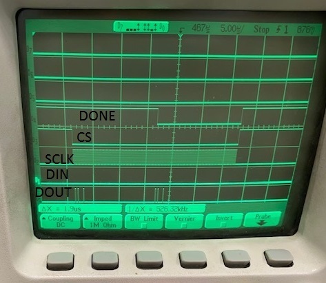

The following pictures show what we are getting from the scope, we got some fault for /DRDY but not as frequently which is why we are not sure if this is the sole problem
and this is what we got:
We checked all the registers to make sure we are configuring them correctly, and all gave us back wanted results. both DONE and CS/ /DRDY frequencies match.
Do you have any idea what the problem might be? We had a problem previously for not getting a response from the second device, but the problem was fixed by sending the command after the DONE goes low for the second device.
  • Shada,
    Are you getting 0s for the output data of the second device? Is the second device not sending out /DRDYs? It appears that you have the channels to check this with your mixed signal digital scope. I would look at the /DRDY to verify that the device is actually converting. I would also note that there is some latency on the data output, which I explain below.
    This device has a sinc3 filter, which means that it reports a moving average of three conversions. I'm not completely sure if the output is suppressed until the digital filter is full (meaning that the output stays 0s for the first three conversions), however it may for this device. Additionally, this device has an output data buffer to read from DOUT. That means that even if the settled output data is collected by the 3rd ADC conversion, there is one more delay of conversion time until the ADC outputs the data. This means that the output data will be ready by the fourth /DRDY pulse.
    At the minimum, you should be able to see that the /DRDY pulse is transitioning from high to low at the data rate. This will tell you that the second device is converting. After that, check that the output data is coming out of the ADC by the 4th /DRDY pulse.

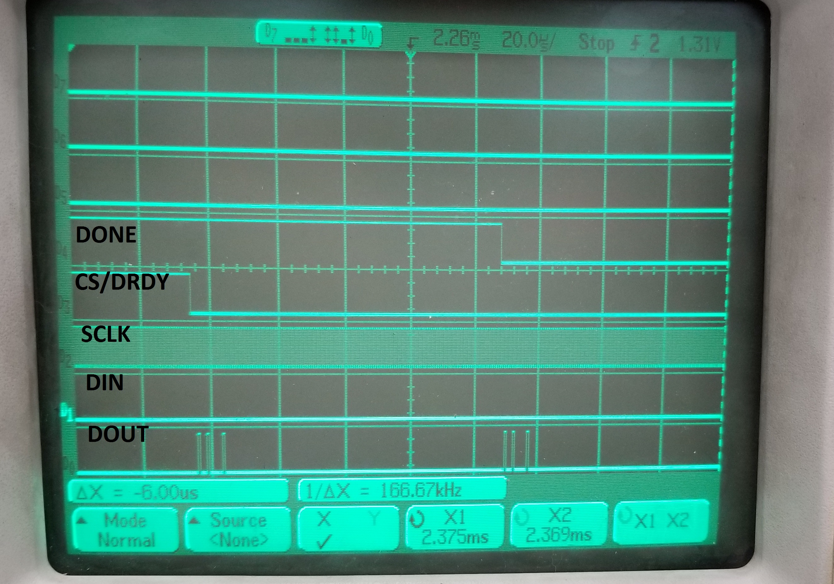

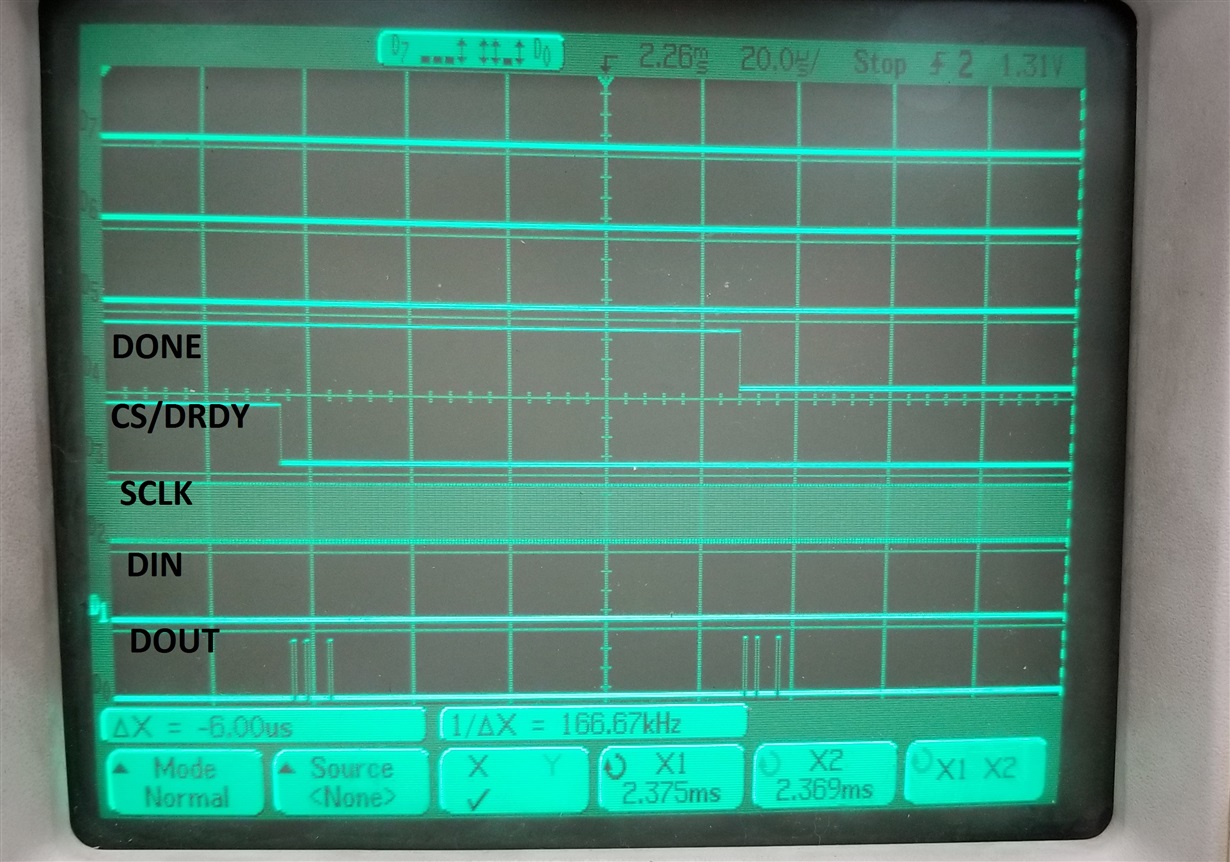

    After enabling and locking the ADC we are getting the following status : 2204h
    Our SCLK coming from the FPGA is 7.63MHz, from the Table 29 and Table 30 we calculated our fdata rate to be (7.63MHz/(8*400)= 2.384kHz
    From the datasheet, it was mentioned that the data rate and DRDY need to be the same frequency or multiple thereof, does this have to be exact because we keep getting the F_RESYNC high at every CS toggle.
    Zoomed out image:
    Zoomed in:
  • Shada,
    Sorry about the delay. I've looked through your sequence and it looks like it should work. There's nothing unusual about the setup that I can see. I would note that the ADC response after the LOCK coming from WREG 0F 0F should be 0555h. That would come as a response in the next frame. If you sent a null command in the next frame, the frame after would be the STATUS response which would be the 2204h response with the F_RESYNC error.

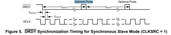

    If you set CLK1 to 82h, then the SCLK coming from the FPGA is used as the ADC clock source. I would note that the timing for the data rate and the /DRDY synchronization must be exact or the device will give the F_RESYNC flag.
    For your setup, it seems like your math is correct. The 7.63MHz for the SCLK, is used for clock source. The ICLK_DIV is 8, and the oversampling is 400. Instead of calculating the data rate, I think you need to count the number of SCLKs in the data period. With the given SCLK rate and configuration, this would be 1600 clock cycles. I think there will also be some tight timing with SCLK to the /DRDY synchronization which is shown in Figure 5.
    One thing you might try would be to start with no /DRDY pulses just to check the ADC read. I would note that if you don't get the timing right, you will eventually lose synchronization, which might cause you to skip a read or read a data twice eventually depending on the timing of the data read. In synchronous slave mode, I still think you'd want the /DRDY to verify the master timing though.

    My sync timing t_su(sync) and t_h(sync) are both equal to 156ns so I am assuming it is okay as they are more than the 10ns minimum noted in the Timing table.

    The schematic in Figure 100 is correct, you could use the /CS to select the device for SPI communication and you could also use that same /CS to trigger the /DRDY to synchronize the devices for synchronized slave mode. However, the synchronization pulse is optional as is shown on Figure 5.
    If you started the device without the optional /DRDY pulses (no pulses on /DRDY at all), the data could be retrieved without device constantly re-synching. I suggested that the /DRDY not be pulsed so that we could check to makes sure that the data is coming out of the device. If the timing of the synchronized pulse is incorrect, this becomes difficult to debug.
    If you can't separate /CS from the /DRDY, I think you may need to play with the /CS timing. Again, I think that with your settings, there would be 1600 SCLK cycles After the first read, count the number of clock cycles from the fall of the /CS to the next fall of /CS. Just in case, there's something we missed, vary this timing from from 1590 to 1610 SCLK and read 10 data points for each case. For each data read, I would check the result from NULL command response for each of these reads. Note that the NULL response gives the STAT_1 reading each time, and you can check to see if the F_RESYNC flag is set each time.
    You could also vary this timing at a much larger range and see if we've missed the data rate calculation. You'd read the F_RESYNC flag for each of the NULL commands used for reading data.
